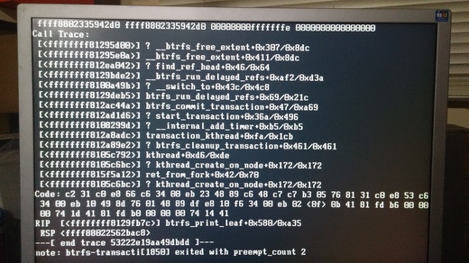

Unraid crashes 10 seconds after booting up, with the attached screens coming up then the system is unresponsive.
I have replaced the RAM and run memtest to make sure it is not the RAM.

Since it references BTRFS, I'd physically disconnect any BTRFS formatted drives and try again. Obviously that's not a solution, but it would be my first troubleshooting step.
Thanks for looking into it for me, unfortunately no drives are formatted BTRFS, I have never tried that file system.

Well, try disconnecting the drive that holds your docker image and see what happens.
I unplugged all the hard drives, and unraid boots and does not crash!

Based on what's been said so far, I think there is a corrupt docker image causing the crash. They are all array disks, so trying to start the array will cause the crash, no matter which disk is removed. If all the disks are present, the array tries to auto start. Removing one disk, any disk, causes the array to stay stopped until manually started. I'm hoping maintenance mode will allow the array to start without crashing. Also, diagnostics would be very helpful.

Do you know which drive has your docker image on it? Does that drive have other data besides the docker image?
No, I cannot access the Docker section of the web browser GUI to determine which drive has the docker installed on it.
And yes that drive does have other data on it.
Open \\piketower\flash\config\docker.cfg and change
DOCKER_ENABLED="yes"
to
DOCKER_ENABLED="no"
save, shutdown, and reboot.
I disabled the docker, and it boots and starts the array and stays stable, no crash.

At this point, you have 2 options. Rebuild, or set a new config and reassign all drives, check to trust parity, and do a full correcting parity check. If it were me, I'd do the new config.
If that's the option you want to take, make sure you know which drive goes in which slot by serial number before you set the new config. A screenshot of the main page is good.
After you get the array all green one way or the other, you need to delete the docker image file on disk1. Then you can let the docker manager create a new docker image file on the docker settings page and enable dockers again, and on the docker page add a new container, selecting the my-plex from the select a template drop down.
