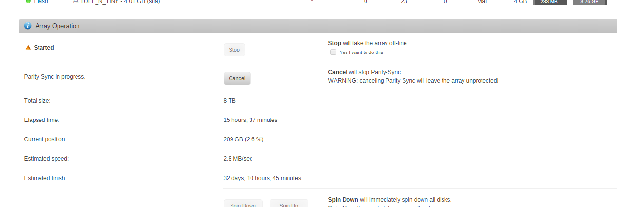

I upgraded my parity and adding 5 more drives to my server. When I replaced the parity I did not see a copy file from the old parity for the new parity drive. So I went ahead and started the parity sync but it shows that it will take over 20 days to complete. My question is if I shut off the server to add the norco hot swap and to use for pre clear on new drives will I lose the parity progress?

Yes you will lose the progress.
But, at 20 days, there's something else going on (most likely you knocked loose a cable somewhere along the line).  Diagnostics would tell the tale
Are you sure you're doing a parity sync? Suspect you're doing  a correcting parity check that is finding many errors,  that would explain 20 days.

I do have 34TB would that make a difference
I have 73TB and it takes me roughly 24hrs to do a parity sync, so I think there is definitely something else going on with your system. 2.8MB/sec is very slow, that should get up to the high 80's or higher, how long did you leave it for? Perhaps it will speed up and that figure of 20 days will drop?
Total size of the array doesn't make a difference for time (depending upon your hardware of course)
2.8M / sec is definitely not normal UNLESS you are running all your drives on PCI adapters.  Like johnnie said, either its finding a ton of corrections, or like I said you've knocked a cable loose.
I'd post your diagnostics
No, that's way too slow,  post diagnostics.

I am using this SUPERMICRO AOC-SASLP-MV8 PCI-Express x4 Low Profile SAS RAID Controller with with 2 Mini SAS to 4 SATA Data Cable supplying sata to 8 drives. The other 6 drives are running off mobo sata ports.

i have a couple of those controllers on my system.  I get parity sync speeds in the 80-120MB?sec speed so you should be seeing something similar.
I had installed a rocket raid 2300 for the new norco ss500. I removed that from the system and now I am getting 30mb/sec. I checked all the wires and not loose connections. When I install the rocket raid do I need to do something in the bios? I am getting 20-30mb/sec but to be very honest I know replies say to post diagnostics but I do not know what that means.
Go to tools and click diagnostics, attach the complete zip.

Thanks so much, my speeds are back to 3mb/sec. I am attaching the diagnostics zip file. I apologize for being such a technie noob and greatly appreciate the help everyone offers here.

You are getting CRC errors from at least these three disks, change sata cable/enclosure.
