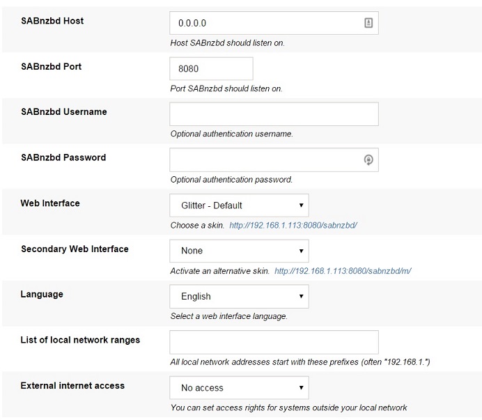

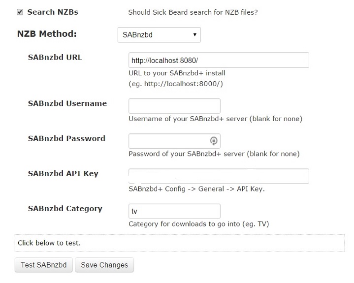

Probably prudent to post screen shots of the port mappings and applicable settings for both SB and SAB
LinuxServer's for both Apps.
Screen shots attached
I erased the API Key BTW, before someone tells me it's blank.
I do see this error in SB: 2016-03-06 12:37:06 CP Server Thread-5 :: Unable to connect to SAB: error [Errno 97] Address family not supported by protocol
change the URL SB is trying to talk to Sab from local host to your actual IP address of the server
Getting warmer, now it's bitching about the API authentication.
I reset the key, saved SAB & SB, restarted both, but I still get:  Authentication failed. SABnzbd expects 'apikey' as authentication method. The key is the same in both places. I will try the NZB key instead.
OK, so it works if I tell SAB to grant full external access. It does not recognize 192.168.1. as an internal address. even if I put it in the range of internal IPs.
