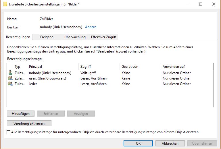

While I was working on my unraid 6 server and adding it to owncloud, I pretty much suddenly lost write permission on some folders in a share.
When I go into the advanced security settings of that folder, nobody (unix user \nobody)  is the only user that has full access. The others only have read and execution permission. (as shown in the picture)
But because I am someone and not nobody ;) I don't have permission to do anything else than reading. -> I can't create new users or modify any settings of existing ones.
Is there a way to solve that issue except starting from scratch? (which I don't want to do if somehow possible)

users/nobody is the default for all files on unRAID and that is correct. You really shouldn't be looking at this from a Windows share security perspective, and definitely shouldn't try to change this from Windows.
The only thing that should matter is the SMB security settings for the particular share you are trying to access. If it is public then everyone has read/write. If you have set it to secure or private then you need to connect to your server with a user that has permission. You may have to go into Control Panel - Credential Manager and delete any credentials for your unRAID to get Windows to make you login again since it will remember how you connected to it before and will continue to use that. Windows only allows network connections to shares by a single user per remote machine and it won't even prompt you to login, it will just keep using the login it has already established and tell you access denied.
The nobody user I was talking about is on the windows side of things.
The share is a privat one and I am connected to it. The thing is, that I have full read/write permission on some folders on the same share and only read permission in others.
With Windows it is important that you first connect to the private shares before the public ones.  This is because Windows does not handle the other way around properly, and can give a misleading error message.    You may have to first go into Windows Credential manager to clear any stored credentials for the unRAID server.
Forget about what you are seeing on the windows side of things. Close that window that you got that screenshot from and don't look at it again. Concentrate on the other things we have already suggested.
That is not the problem because everything worked on the pc and I had full access to the privat share. (just to make sure, I disconnected all shares and connected again with no change of the situation) I can still use most of the share just normal only certain sub folders of the share have the problem.
(and no, I'm not talking about the window but the actual problem that I can't write in those folders)
