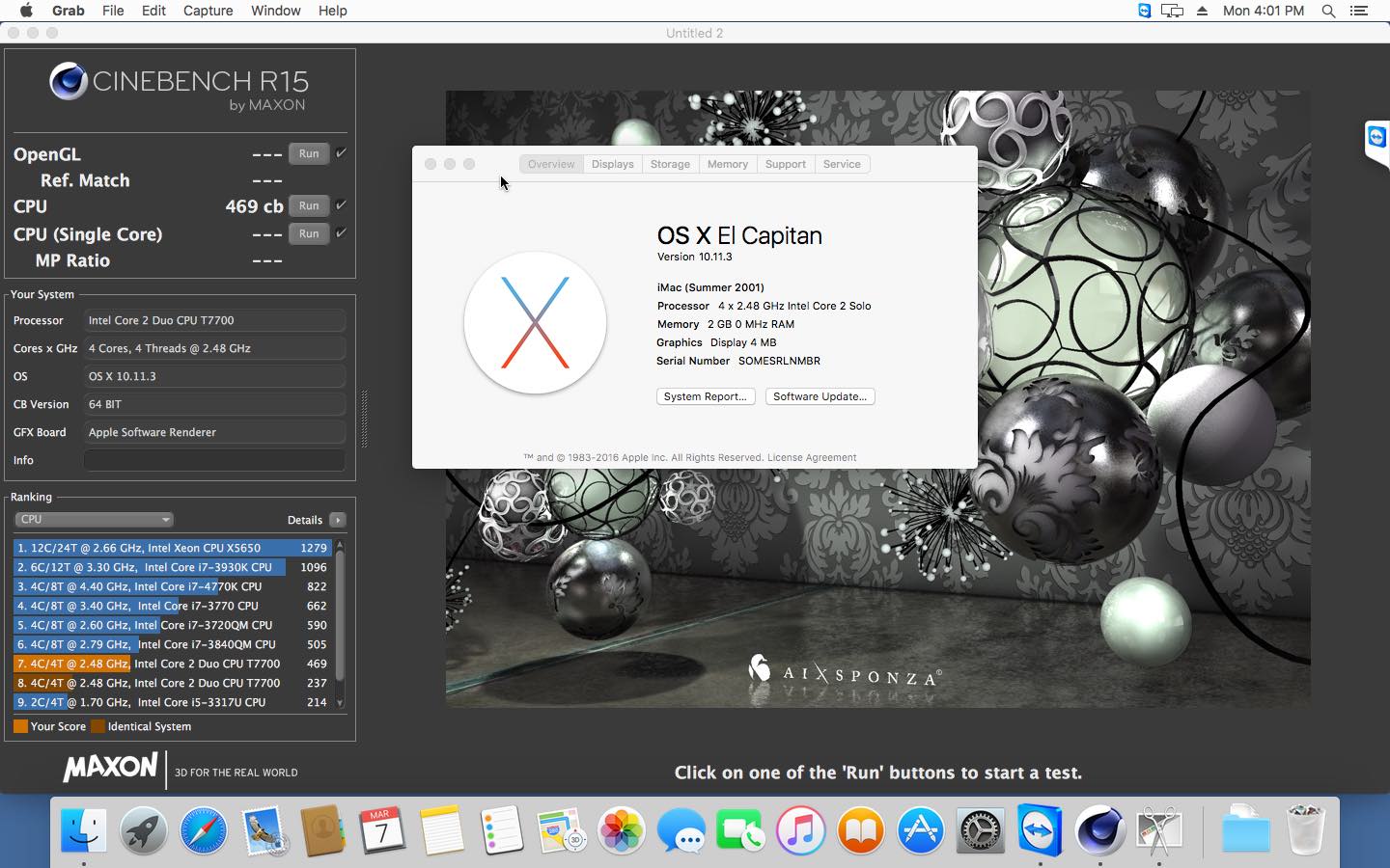

After reading this insightful article by archedraft on Mac OS X KVM Virtual Machine https://macosxvirtualmachinekvm.wordpress.com/guide-mac-os-x-10-11-el-capitan-vm-on-unraid/ I decided to test it out on my unRaid system at home. After ironing out the bugs and successfully implementing multiple VMs of Mac OS X, I figured I could move this solution to our small server room at work.
Looking for anything I may have missed or feedback.

Are you running OSX Server in the VM?
Yes. 10.11.3 with Server installed.
