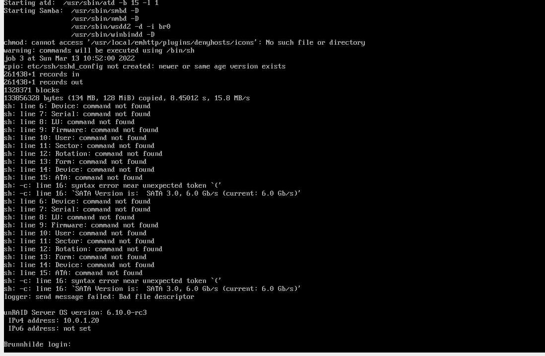

Console errors after updating to 6.10 RC-3.

On 3/15/2022 at 6:22 PM, unraidyn said:
Doesn't appear to work on Unraid 6.9.2, as I can't get the WebGUI to load the 'SSH authorized keys' box on the 'Edit User' page. Both of my other 6.10.0-rc2 boxes however loads this fine. Logs are empty and so is the console, there doesn't appear to be any errors, it just doesn't load the WebGUI on 6.9.2. See attached both screenshots. Should also mention I've done multiple re-installs, which has no effect.
6.10.0-rc2:
6.9.2:
I was not aware that 6.10 was introducing the ability to edit the authorized keys for individual users. That appears to be native unraid functionality which may obviate the need for my plugin beyond 6.10.
I did a little testing with 6.10 a month or so back when someone reported an issue with the plugin. I have since rolled back since I was doing the testing on my live system. While testing I didn't use or even look at the edit user screen(s).
I'll fire up another test to confirm that 6.10 allows both root and other users' authorized_keys to be edited.
The "official" word about end users vis-a-vis logging in is that unraid isn't meant for that. Users are only for share security. It is possible and I would say LIKELY that the edit users screen will ultimately only allow editing authorized_keys for root.
1560253194_ScreenShot2022-03-13at10_56_02AM.thumb.png.4ad04ebeb2bdb31d7f5e8b2c9e7cec55.png
Thanks for the report.
I'll be doing some additional testing on 6.10 this week. I will make sure to check what is happening there. I added code to extract the native sshd_config from the bzroot with the intent of eventually comparing that to the copy my plugin edits and reporting any "drift". Right now there is no other functionality depending on that extraction so short term I will likely just disable it.
My instinct tells me that the kludge I have to use to get the / (root) volume out of bzroot stopped working.
