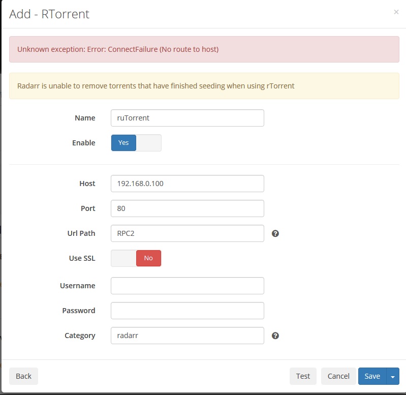

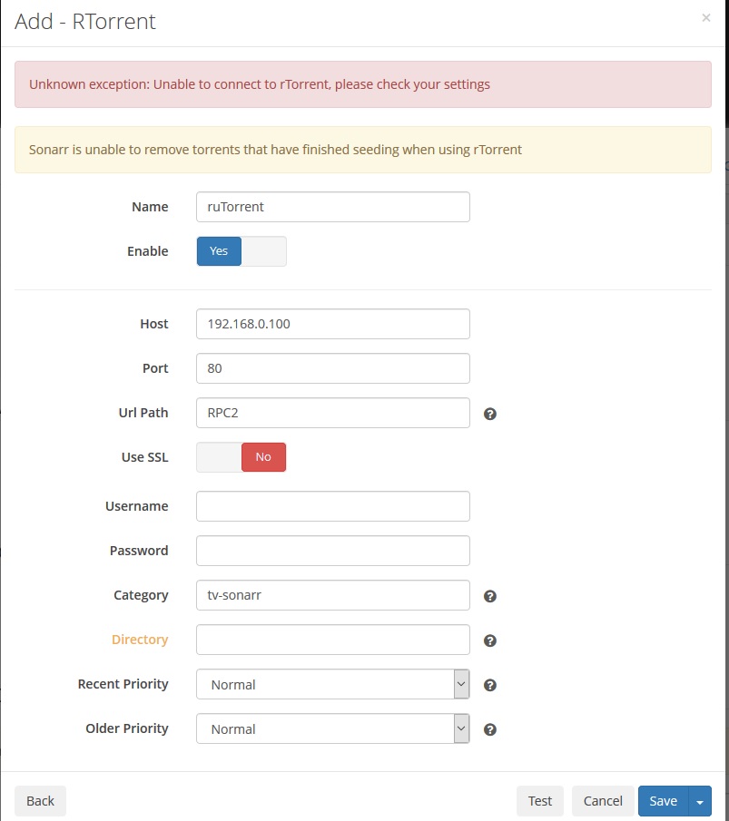

I installed rutorrent, but that's it, and when I click on web ui from my dashboard, it just sends me to the tower/main.  Even if I change the port to say like 93 instead of 80 (just a random port), I can't get to any web ui.  But is that because I need to also install rtorrent with rutorrent before rutorrents web ui functionality will work?
No you don't have to install anything else.  You have a configuration issue with your ports.  I have it set up in a bit of a non-standard way but you can the way that I do it.

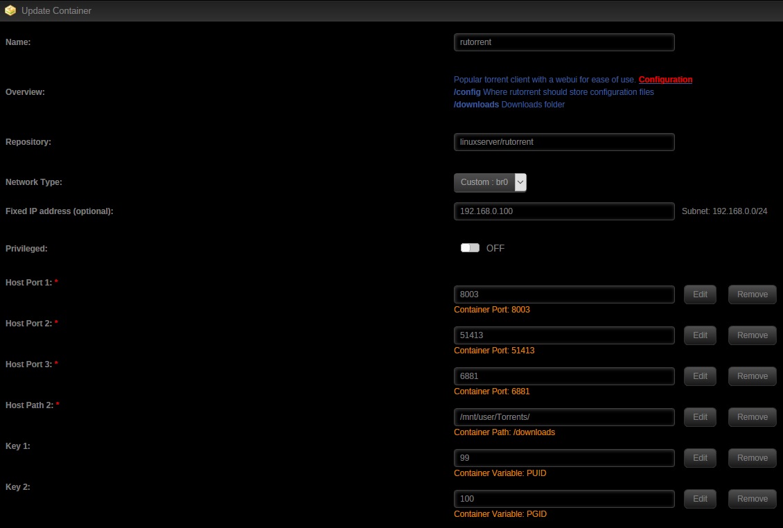

Change network type to br0.  Then you will have to set an IP address to an unused IP on your LAN and you may want to set it to an address that is outside of your DHCP range.  I use 192.168.1.240.  Then you can keep the port at 80 and it should work.  But make sure that the IP address that you use is on the subnet that you are using for your LAN - this is usually 192.168.0.X or 192.168.1.X
So when I change it to custom: br0 and set the ip to say 192.168.0.100 (because I don't have any subnets at the moment, everything is .0.x on my network, I can access the webui no problem.
But then when I go to connect it to say Radarr or Sonarr, I get errors and am unable to connect those to the rutorrent.  These are my settings.  Also, I'm really storry if I'm being annoying.  I'm slowly learning.  And I am attempting to google search the best I can on all of this.  This was so much easier on Windows haha.
Also, note the first SS says ports 8003.  I tried Sonarr and Radarr with that set to 8003 and 80 updating both Sonarr and Radarr to reflect which ever port I had rtorrent configured at.  I never set up to user name and password for rutorrent.  Could that be why it's not able to connect?  Though I don't understand the host part for Radarr.  Also, why is it deluge works as a bridge network type (as long as I don't use port 90), but rutorrent won't?
if you change a port change the host side only because nginx in the rutorrent container doesn't know you've changed the port and it listens on port 80 still
but if you change the host side only to say 8003 it will be mapped to port 80 in the container
I'm so mad (probably at myself, but I don't even know who or what I'm ad at), but I ended up just deleting the entire rutorrent docker all together.  reinstalled it.  Everything works flawlessly.  Everything is connecting.  It's working with a bridge connection instead of it's own IP.
Thank you guys.  With your help, and my navigating, it was a learning experience.
This is the key to your frustration. When you assign a docker to have its own IP, it is no longer allowed to access the host unraid IP, so it can't connect to any bridged dockers. This is a security "feature."
It's assumed if you want 2 docker containers to talk to each other, they will either both have unique IP's, or both bridge to unraid's IP. No mixing.
That's not quite true.
When a docker container gets its own IP, it can no longer talk to host unRAID on the same logical interface (network port). This is a security feature design by the Docker devs.
However, if you have an extra interface that is not bonded to the main interface, you can enable it with out assigning it an IP and use that interface for the docker container. This will then allow the docker container to reach the unRAID IP.
Granted, but my point was that the way the poster was trying to do it wouldn't work.

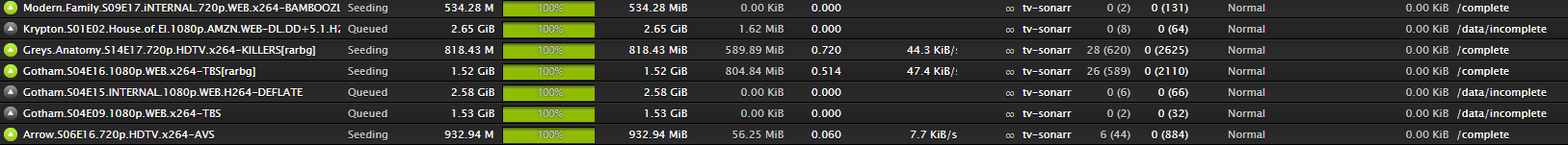

This automove issue is really annoying me atm. I just got this all to play nice with sonarr first 4 files everything went smoothly. moved from /incomplete to /complete. then all of a sudden no more files will get moved.... I have no idea why... Anyone managed to get this working as it should? or is there a way to set this in the rtorrent config file so it doesnt need to use a plugin?
EDIT
Ok i seem to have figured out that for some reason it has now started to pause the torrents upon completion. which is resulting in them not being moved. I can manually restart them and they seem to be moving ok.... Any idea why this might be happening?
EDIT
I've had that issue for a while. Mine doesn't pause the torrents but half of them just never get moved. I think it's just a bug. I've brought it up on the rutorrent github but the dev never seems to respond to anything. I ended up just turning the automove off. It creates more of an issue for me to have completed torrents in two different folders than it does to have complete and incomplete torrents mixed.
Although, as I write this, I wonder if the check hash on completion setting might have something to do with it not moving. I think I'll play around with that.

Yea tbh i just found it very strange that literally the first 4 torrents worked perfectly and since then 0 torrents move. It gives the appearance that the torrents pause on completion because if i right click and start them manually again they get moved.
EDIT
Ok upon checking again it appears that alot of the torrents have now moved... however sonarr and CP no longer copy them to my media shares like they did at the start.... I can manually import with sonarr but that is not exactly ideal really...

I didn't take a close look at your screenshot before. rtorrent isn't pausing your torrents, it's queuing them (also why they eventually moved). I'm not sure exactly what the issue you had with the automove was but this doesn't seem to have to do with it. Your automove looks like it's working fine. You just have to go into the rtorrent settings and change it to allow more simultaneous downloads ("number of download slots", under the "connections" section). Even still, that shouldn't mess anything up with Sonarr. If the download is queued or paused, or even stopped, Sonnar will just leave it there until it is done. I'm not quite sure what the issue you are having is now because it looks like some of your assumptions were wrong. What is it that is happening and what is it that you would like to happen?
