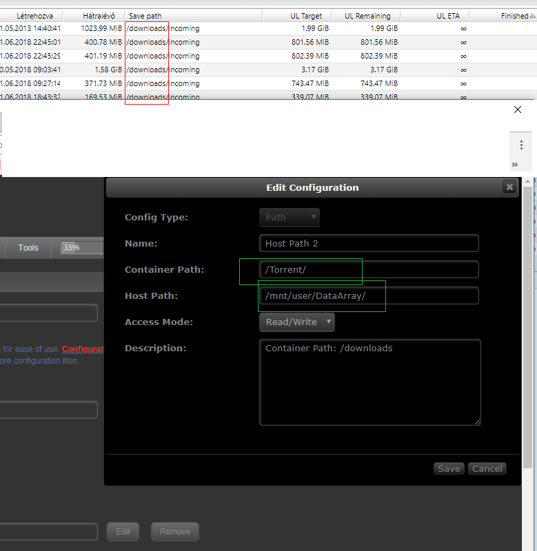

hello,
i can not modify the following folder: Save path on the webUI: /downloads/incoming
(right click, save to.. and nothing happens, i think the correct webui save path should be: /incoming/ )
unraid container settings:
Container path:
/Torrent/
host path:
/mnt/user/DataArray/
the second issue is, (transmisson worked fine on the same port settings) 51413 (default) "port is closed" appears and download progress (and seed, the seed shouldnt be working on the "wrong" path settings..) does not work.
it was working fine in the last week.. but (since the last update?) it has been broken somewhere..
(is it possilbe to revert "manually" from unraid CA  ? )
thank you!

Post your docker run command as seen in the docker FAQ. If that is all the mappings you have for this then /downloads isn't mapped nor is /incoming.

"If that is all the mappings.. "
heres what i mean
2 independent unraid server, same issue with rutorrent update, without any changes(!).
remove, reinstall, remove appdata, reinstall with default path settings, edit path ..somewhere else, "/" without "/" , etc  -> nothing..
so. is it possible to revert? :)
ive installed other clients (qbit, transmission) and everything went fine.

That screenshot indicates the Container path is /Torrent/, not /downloads. You even highlighted that fact.
Yes:) and this is my problem.
step by step.. fresh install.
0. remove rutorrent, clean appdata.
1. CA / find rutorrent / press download
2. On the "Add container" screen i set the following ("edit configuration")
Select container path..
Container path:
/Torrent
host path:
3. Save, Apply. (now i have a clean rutorrent)
4. Start WebUI and add new torrent
>>>>> wrong save path appears on the webUI.
So the next-next finish "installer" in this new/updated version does not work correclty.
and thank you btw, ill try to modify manually the rutorrent.rc
