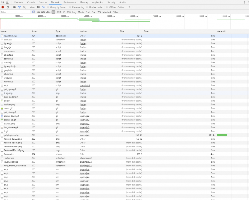

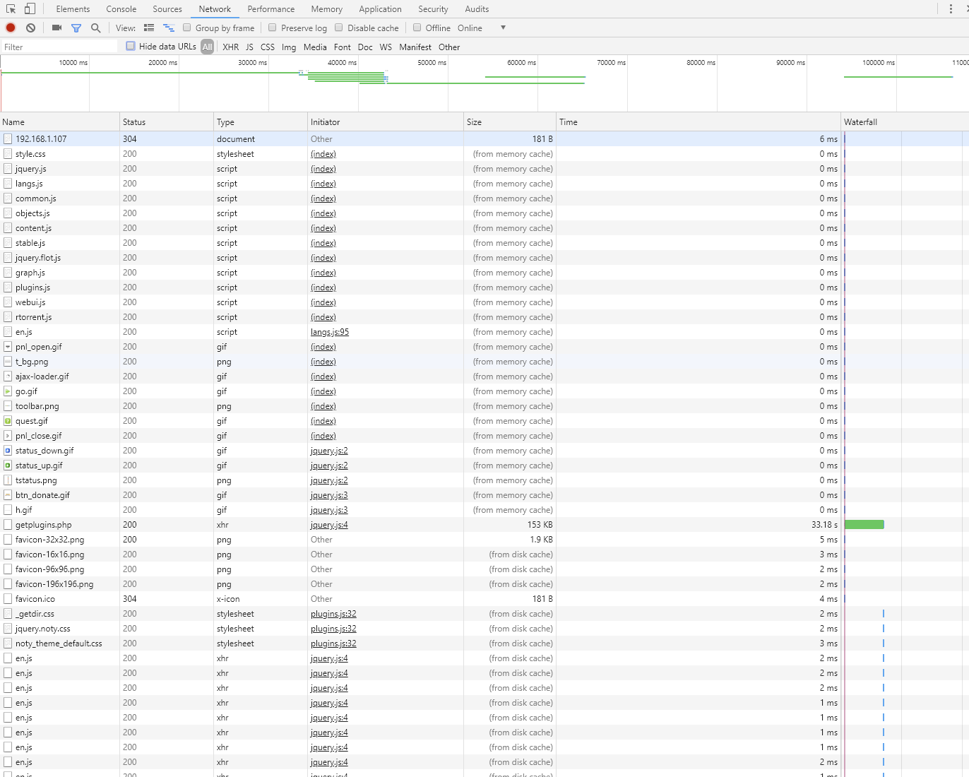

Is it possible to reduce the number of plugins?
I think I've figured out what's causing my issue - the webui hangs for me for quite some time most days, and eventually does start after several refresh attempts. But when it does time out the error is Bad response from server: (504 [error, getplugins])
Loading /php/getplugins.php manually takes several seconds, sometimes more than a minute, and the resulting document is over 10,000 lines.
In attempts to fix this I have:
Fixed docker permissions using the tool
Deleted the Appdata folder for rutorrent and reinstalled the docker.
My server is quite beefy and shouldn't be struggling with this:
2x Intel Xeon 2658v3
64gb ddr4-2133

[28.11.2018 22:38:16] Bad response from server: (504 [error,getplugins]) Gateway Time-out
Edited by Xaero
Here's how much I'm waiting on getplugins.php:
Edit:
Today's update seems to have resolved the issue
Still the slowest part of the page, but several orders of magnitude faster.
Edited by Xaero

Since the latest update I'm back to square one on the abysmal performance front. Everything was fine. 90+mb/s download speeds on healthy torrents, sustainable throughput all the time.
Now I'm back to waiting for getplugins.php for timeouts, and generally unresponsive webui. The rtorrent client itself is also somewhat unresponsive, and the actual throughput is abysmal:
As you can see there's basically no read or write operations occuring (rtorrent is the ONLY process on the ENTIRE BOX trying to read/write data) and it's sitting at 90+% IOWAIT with 0% SWAPIN. I don't even know how to approach this anymore. I've tried tweaking rtorrents settings, php's settings, but to no avail. I should also mention none of my other applications or dockers are suffering performance impact of any kind. (I have MineOS running a modded minecraft server, Plex, and gitlab - none of which are seeing any performance problems.)
