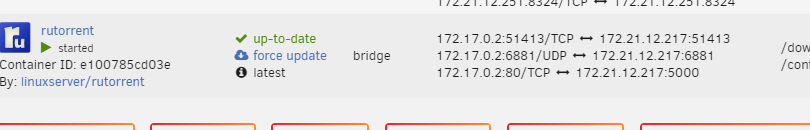

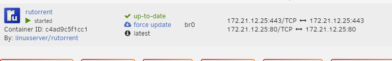

I wanted to give the rutorrent a custom ip address
i went through the setup and changed network mode to bridge and it works fine, gives me an ip out of my range in my network though... see below images
When I change the network to custom br:0 and give it an ip like 172.21.12.25 it does not load the GUI and does not work?
any thoughts?

    Just added note to the first post on how to resolve this.

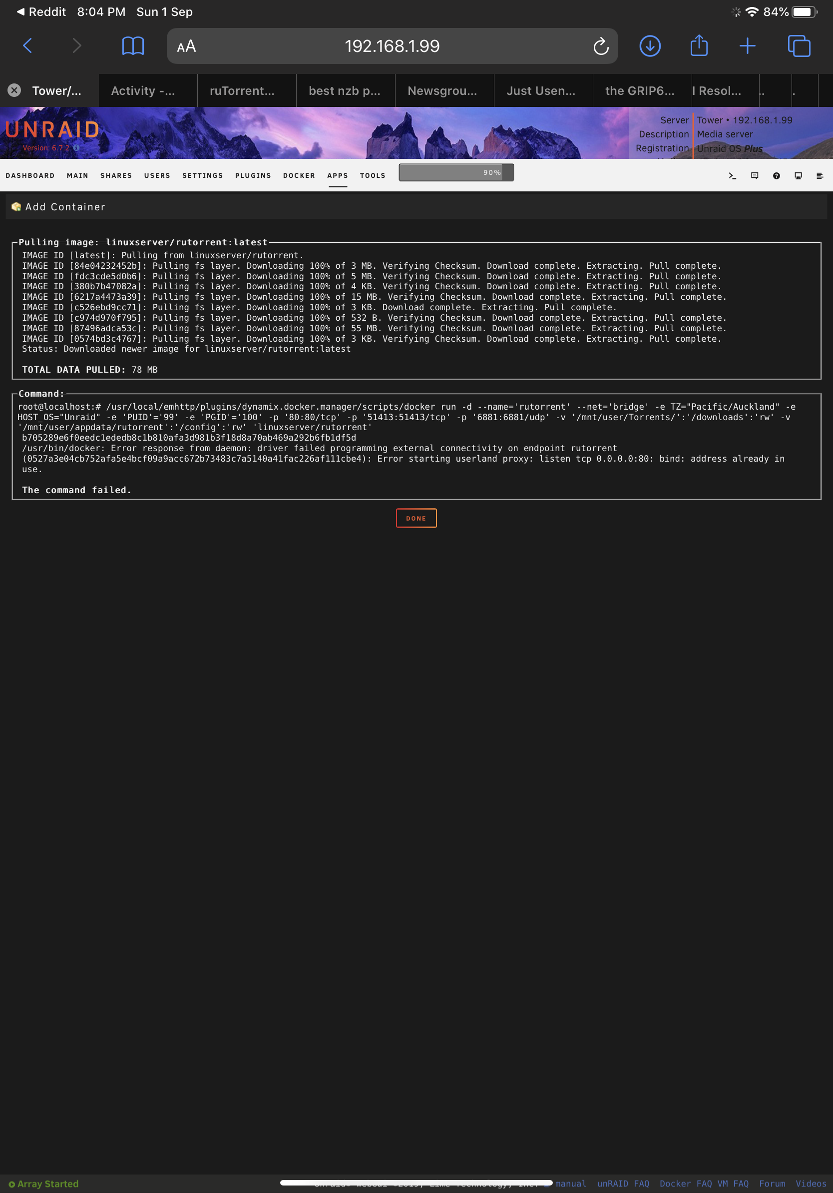

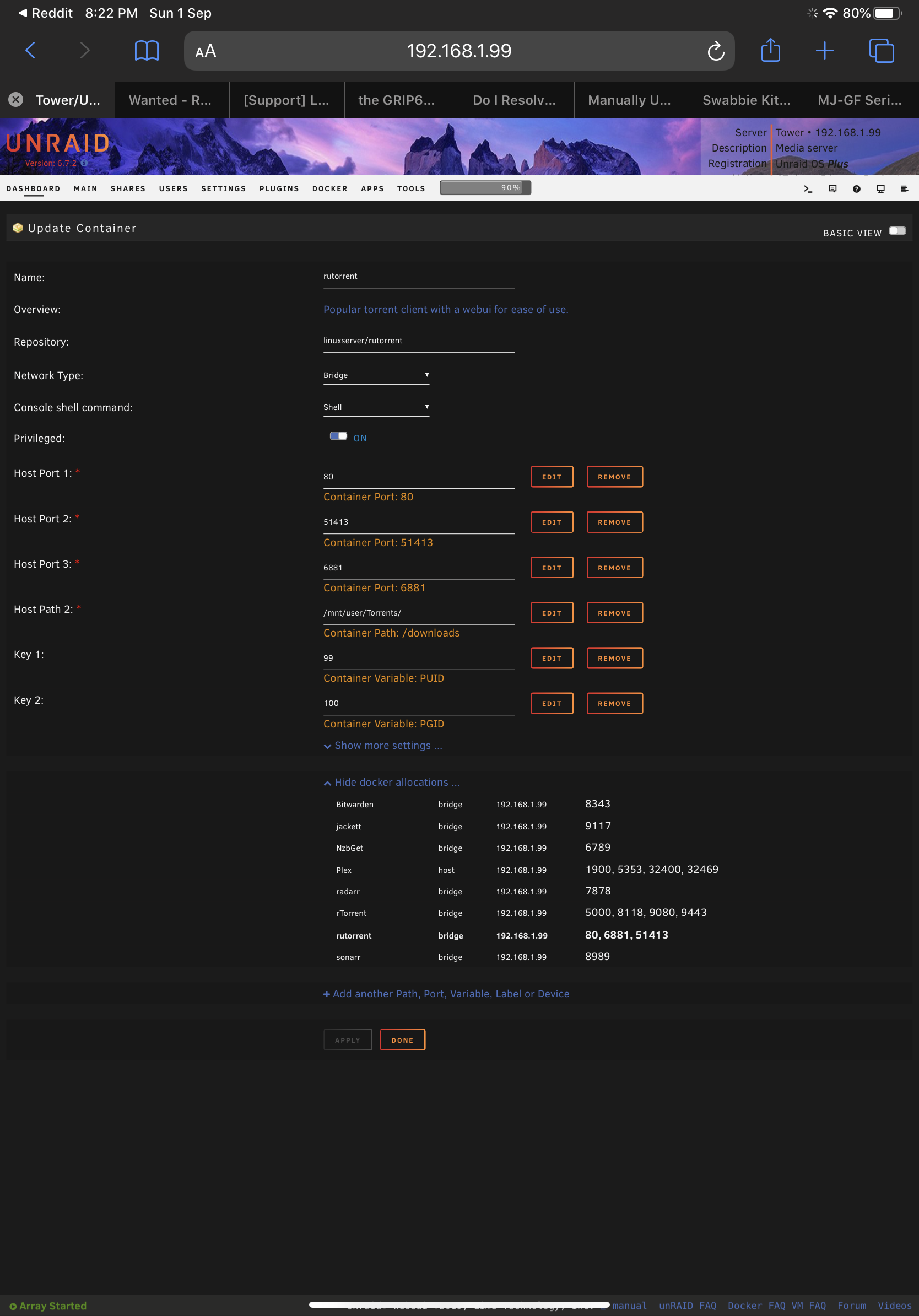

Port 80 is already used by the Unraid GUI. Map the first entry for the Container Port 80 to something that isn't used, like 8080, 8002, etc
