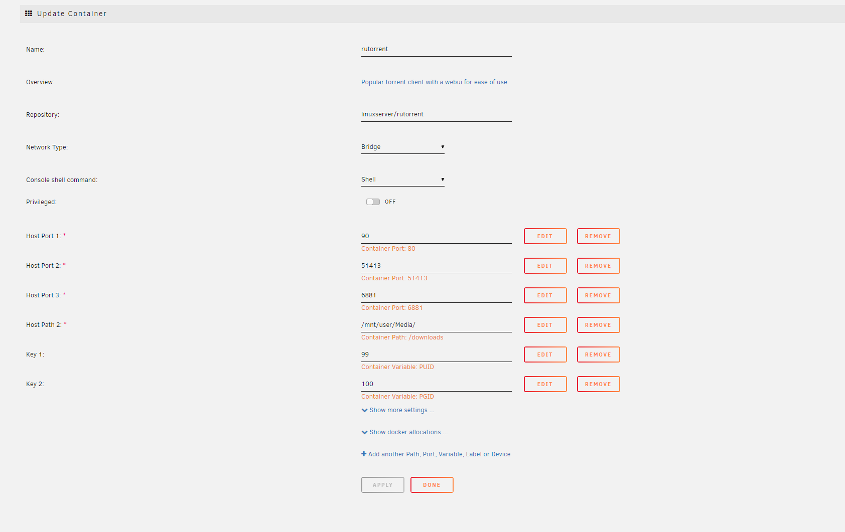

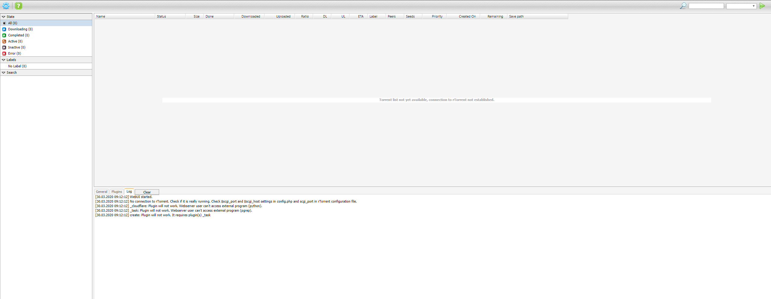

So, I had the other rutorrent docker image that wasn't linuxserver's so I removed that (along with the image) and installed the linuxserver one. I think it was one that was no longer supported and I remember getting a notification to move to a different one. Anyways, I made a mistake in not taking a picture or saving any of the old config files/ports/paths. I figured everything would just work.
I changed the 'container port' from 80 to 90, and the download container path to where my media is stored. I load up rutorrent webui and i get this image. Do I need to install plugins manually (filemanager, etc.)? Also, I don't remember the path to all of the .torrent files I had. Did they get deleted with the old image? I have 34 TB of media.
