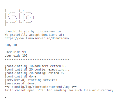

hey guys i need some help, i keep getting this error.
Here goes the log
If i restart the docker it will work some seconds and then it just stops working and start showing error.Capture4.PNG.be47ff01d19970b6a591bb4d409f7603.PNG
Share this post
Link to post

59 minutes ago, trurl said:
here goes the log.
Brought to you by linuxserver.io
We gratefully accept donations at:
https://www.linuxserver.io/donations/
GID/UID
User uid: 99
User gid: 100
[cont-init.d] 10-adduser: exited 0.
[cont-init.d] 20-config: executing...
'access-swap.sh' -> '/config/rutorrent/settings/access-swap.sh'
'access.ini' -> '/config/rutorrent/settings/access.ini'
'access_no' -> '/config/rutorrent/settings/access_no'
'access_yes' -> '/config/rutorrent/settings/access_yes'
'config.php' -> '/config/rutorrent/settings/config.php'
'plugins.ini' -> '/config/rutorrent/settings/plugins.ini'
[cont-init.d] 20-config: exited 0.
[cont-init.d] done.
[services.d] done.
==> /config/log/rtorrent/rtorrent.log <==
tail: cannot open '268' for reading: No such file or directory
And Here Goes the Docker run command.
Pulling image: linuxserver/rutorrent:latest
IMAGE ID [latest]: Pulling from linuxserver/rutorrent.
Status: Image is up to date for linuxserver/rutorrent:latest
TOTAL DATA PULLED: 0 B
Stopping container: rutorrent
Successfully stopped container 'rutorrent'
Removing container: rutorrent
Successfully removed container 'rutorrent'
Command:root@localhost:# /usr/local/emhttp/plugins/dynamix.docker.manager/scripts/docker run -d --name="rutorrent" --net="bridge" -e TZ="Asia/Calcutta" -e HOST_OS="unRAID" -e "PUID"="99" -e "PGID"="100" -p 84:80/tcp -p 51413:51413/tcp -p 6881:6881/udp -v "/mnt/user/Window share/rutorrent/":"/downloads":rw -v "/mnt/user/appdata/rutorrent":"/config":rw linuxserver/rutorrent
f7d1d7c9fb033c1edb8431116f72622d67e714034f53a445c461f80d9cd95c7b
The command finished successfully!
Edited by Max
Share this post
Link to post
@trurl Hey guys could it be all because of some corrupted torrent file cause i noticed that after restarting docker every time, it would start the rechecking process and at somewhere around 20-25 % that error poops in for every single time. So what i did was deleted some of files it was checking when it was around that 20-25 % mark and voila no more error and now its like 4-5 hours since its running perfectly.
So could it be all because of some file that got corrupted somehow.
Share this post
