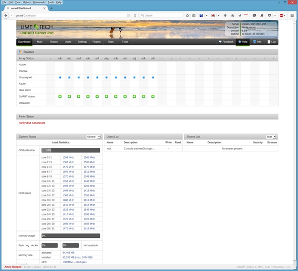

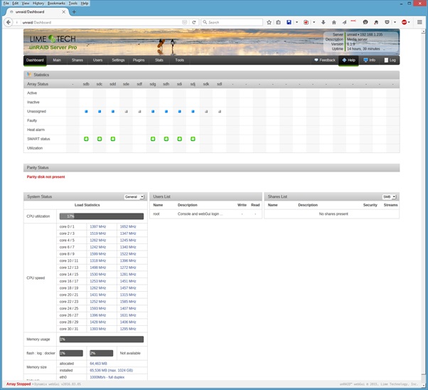

In the dashboard view under statistics, only the 5 drives which are currently being precleared have a blue indicator next to the drive and have the green thumbs up next to the SMART status. The other 4 are grey with no thumbs up.
If I click on the preclear plugin, do nothing else and then come back to the dashboard, all nine drives have the blue indicator and green thumbs up. However after a few minutes the 4 drives which aren't being precleared return to a grey unassigned status.

I've attached some pictures to illustrate the issue.

That just means the disk is spun down to save power. When it spins down the status goes grey and the smart report drops off line (because it's spun down.)

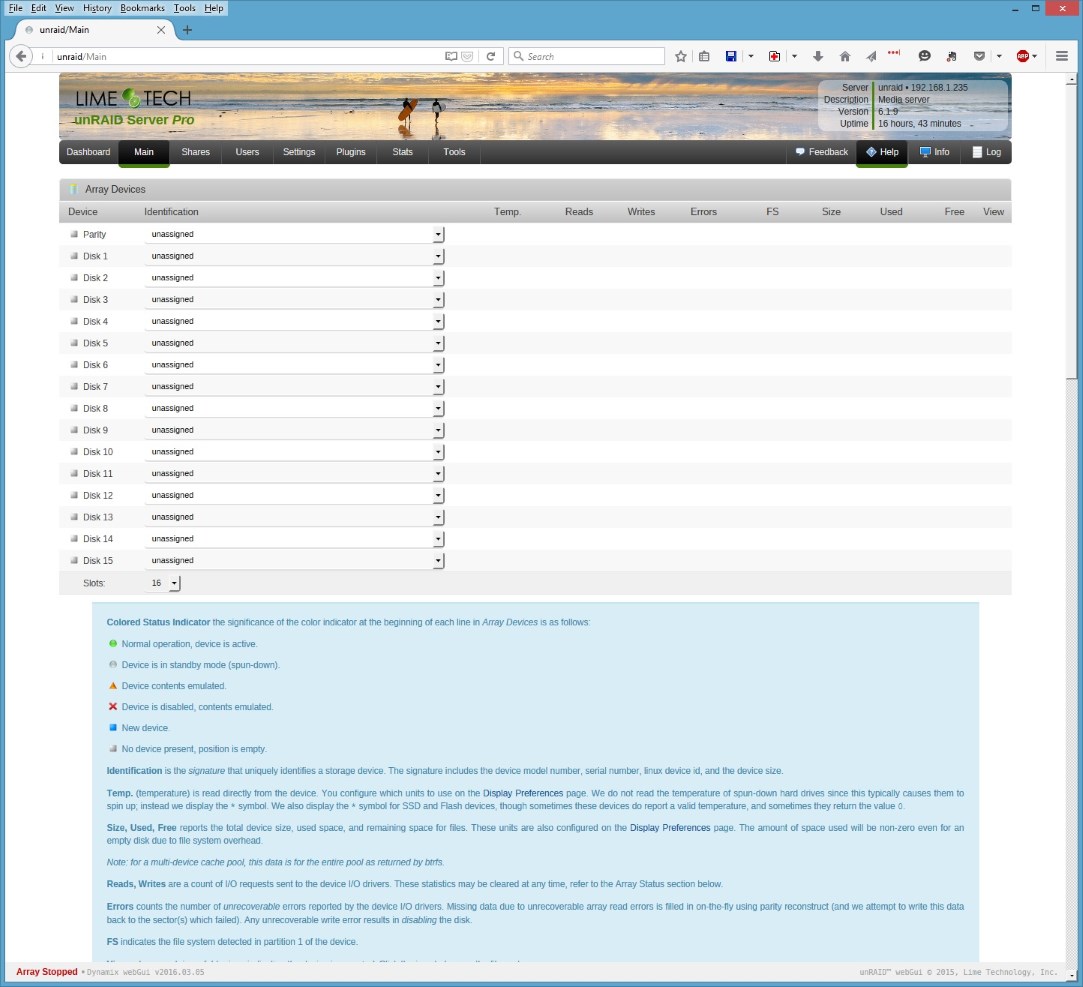

I've attached a picture of what my main tab currently looks like.
As I'm in the process of preclearing all the drives I haven't assigned any drives to devices, so I assume once that is done the icons, etc will appear.
Yes... no sense in spinning them down while they are preclearing... finish thepreclear, add them to the array, start the array... all will be fine..
I think you are correct, and because your array hasn't been started you don't get the controls for spin up or spin down. (I didn't know it worked that way...)
