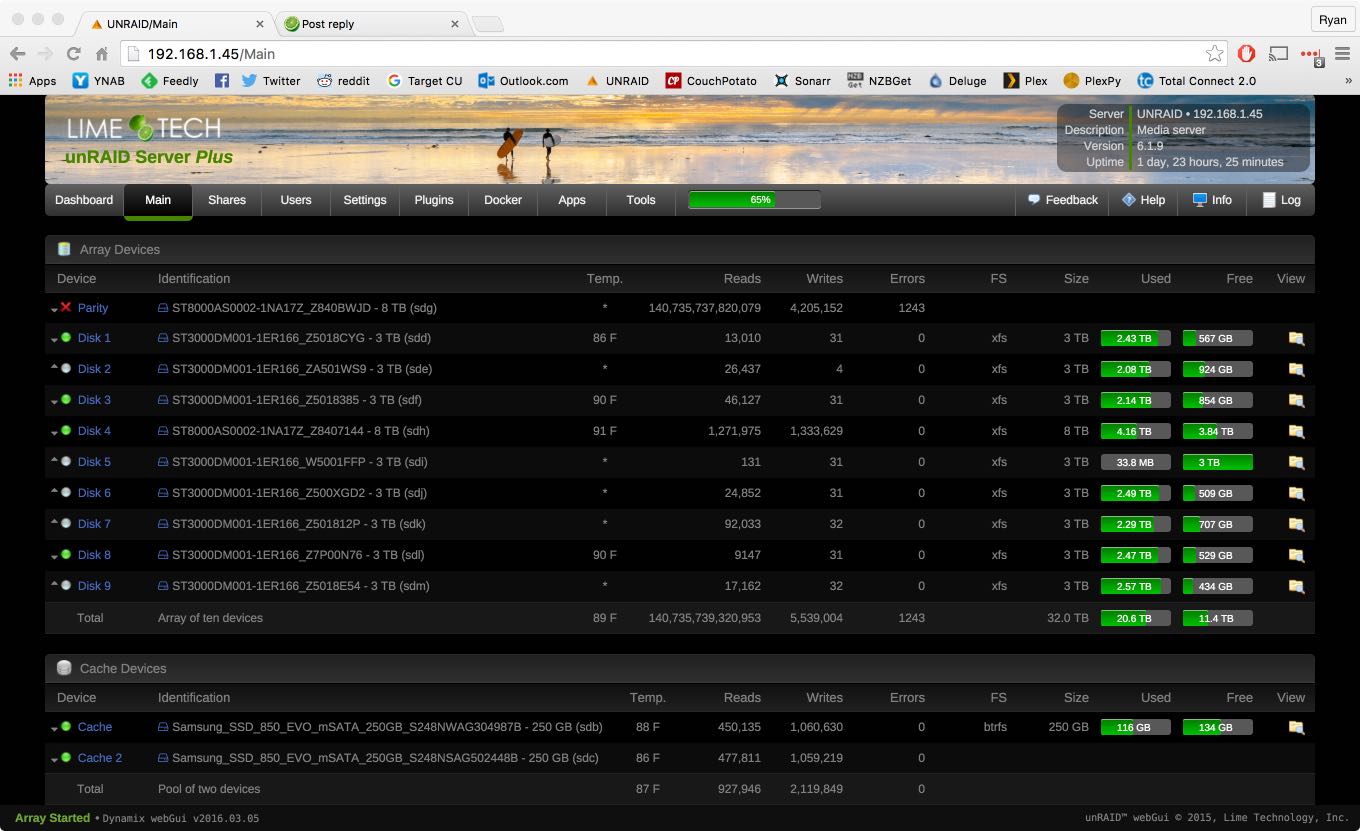

The disk does have the red X next to it (see attached image). As a result I do not see a corresponding smart report in the diagnostics zip.

Ok, I've tried power cycling the box and the drive never came back. I also tried reseating all the cables and still nothing. Looks to be another bad drive, correct?
Thanks!
If it’s still offline after that then it’s probably bad.
