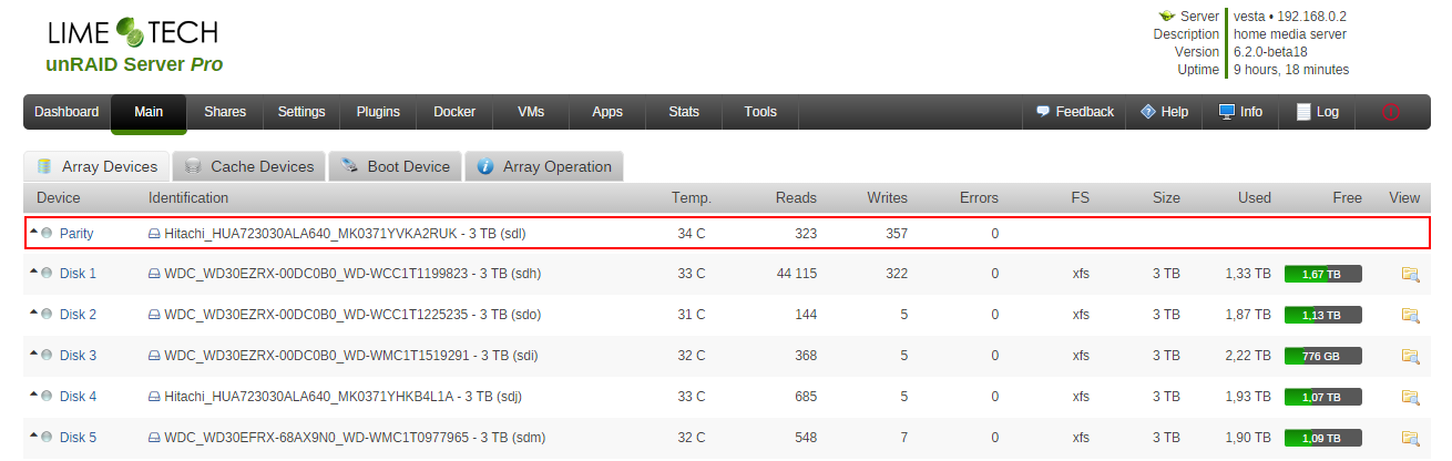

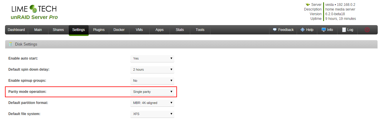

What about the idea to have a setting to select either single or dual parity operation?
This would also suppress a non-present second parity disk when not used.
Attached some examples

I was actually going to automatically hide Parity2 (and Parity) if they are unassigned instead of looking like they're invalid.  It's something on the todo list that didn't make it in to this beta.
