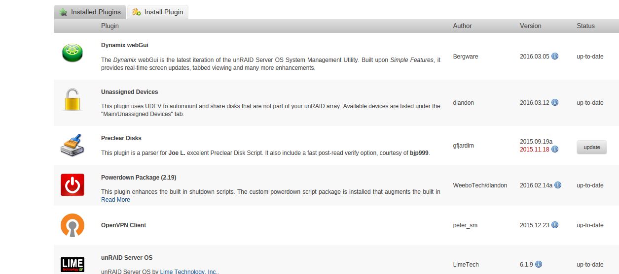

I've removed 90% of all plugins and all but 3 essential dockers and and I can't get this issue to stop.  I even have docker disabled for now.

These are the only plugins left attached showing there versions.  Docker remains disabled for problem isolation.  I am working on the system over VPN which is why the openVPN plugin remains.
Any bright ideas?  The fact I disabled so many components and the problem remains is a little concerning.
