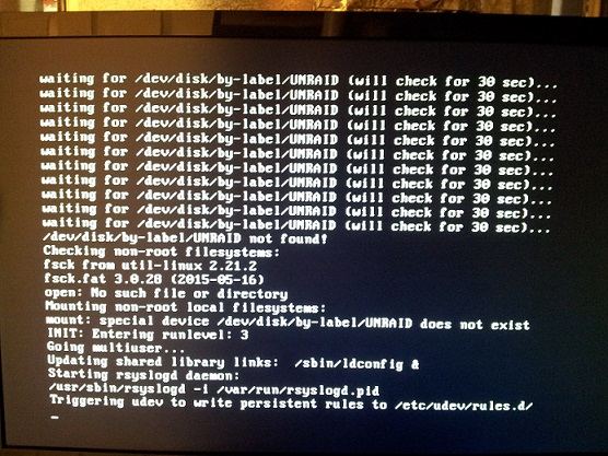

What puzzles me is that I tried:
1)Running a clean V6
2)Running V6 with the .key file only
3)Running V6 with all the config directory
I did all of the above both on the same USB drive V5 works fine on and also on a new flash drive I just purchased.

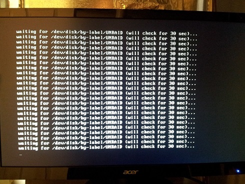

To be clear, when I do any of the above, I get to the point where unraid is loading and then get a bunch of errors. I do end up at the command prompt, but my keyboard is not working and the eth0 adapter is not working.
Not sure if it would make a difference and don't see why it would but stranger things have happened.
Did you try a previous version of v6 like 6.1.8 or 6.1.7 (doesn't look like  6.1.7 is up any longer)?
Maybe you have some other hardware incompatibility like add on cards..
Maybe if you post your system components someone may spot something.

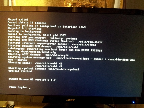

Here are some screenshots from the loading process and the errors it generates.

It's odd that from your images that it looks like the flash can't be found.
Maybe someone with more hardware experience could chime in here..

I notice that during loading, there are several lines that say something to the effect of :
"Unable to enumerate USB devices"
OK, I think the issue is solved now. It turns out that the problem is some sort of issue between the USB 2.0 ports, the Network card and the Unix USB drivers.
This issue affects several Gigabyte AMD motherboards including the 970A-UD3P and the 990FXA-UD3. Turning on IOMMU in the BIOS will fix the problems.
See these links for more details:
http://unix.stackexchange.com/questions/72625/why-is-usb-not-working-in-linux-when-it-works-in-uefi-bios
http://www.misterx.org/2013/12/16/no-network-or-usb-on-gigabyte-970a-d3p-970-chipset-fix-on-centosrhel-6-5/
