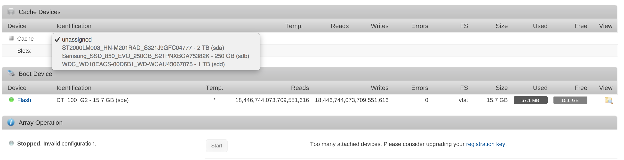

Hi, so i got the "Too many attached devices." message on my trial version, just out of the blue, i've tried to reboot but when it boots up i can start the array, but when i stop the array and want to start it again the "Too many attached devices." comes up again i OLNY have the 3 devices attached, also what's with the reads and writes on my flash, it's only been up for <5mins.

Any DVD drives or card readers installed?
Nope, only the devisees on the screenshot.
How long have you been running the trial license?  Has it possibly expired, or is the time on your system incorrect so it thinks it has expired?
The number of read writes is 0x1999999999999999 when converted from decimal to hex which looks suspiciously like some special error value rather than the actual number of reads and writes.
I suspect maybe the 2 problems are related.
On the banner it says 18 days remaining.
