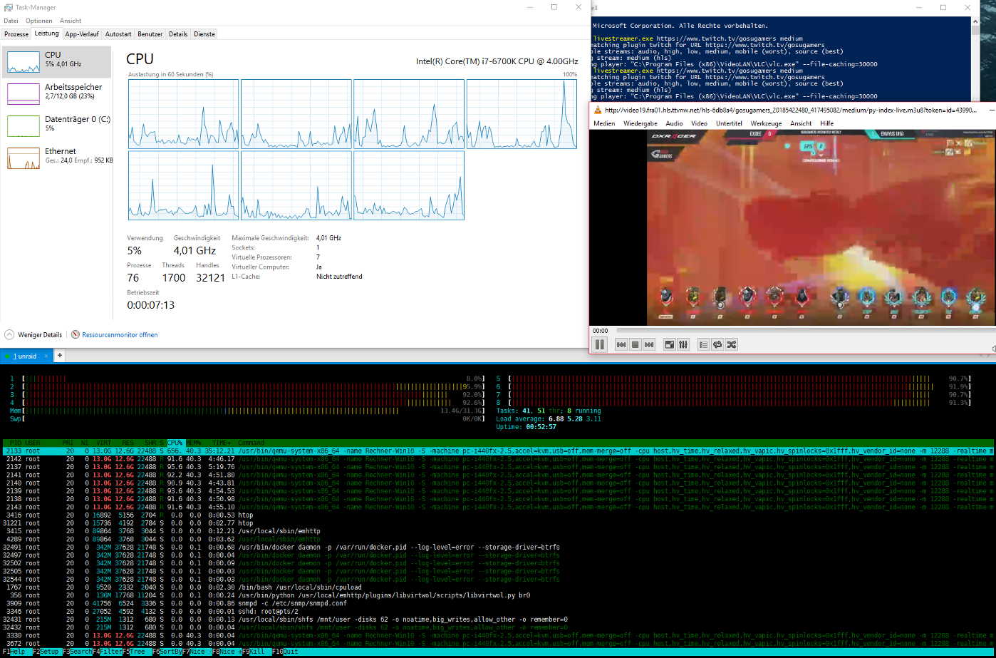

A 1080p h264 movie looks similar, but not as bad. vm 10-20% host 30-50%
And its not just a wrong measurement, cpu temps were also very high (65°C+ on water)
No other vms/docker were running, and only the 7 cores assigned to this vm were on high load.

I can run 3dmark with normal results, so I also think its video/decoding related...

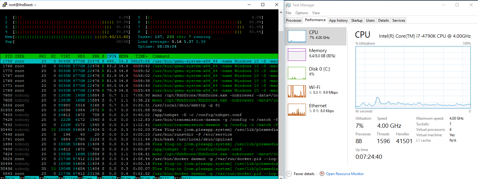

I had this issue as well its a big problem when it is using 40 % of 2 2670s just watching youtube. I also noticed cpu was under user and when you use gpu it goes to system. Not sure i noticed this before 6.2 beta

I am guessing cpu interrupts or context-switches, both seem to really go up (according to vmstat) once I start a video.
