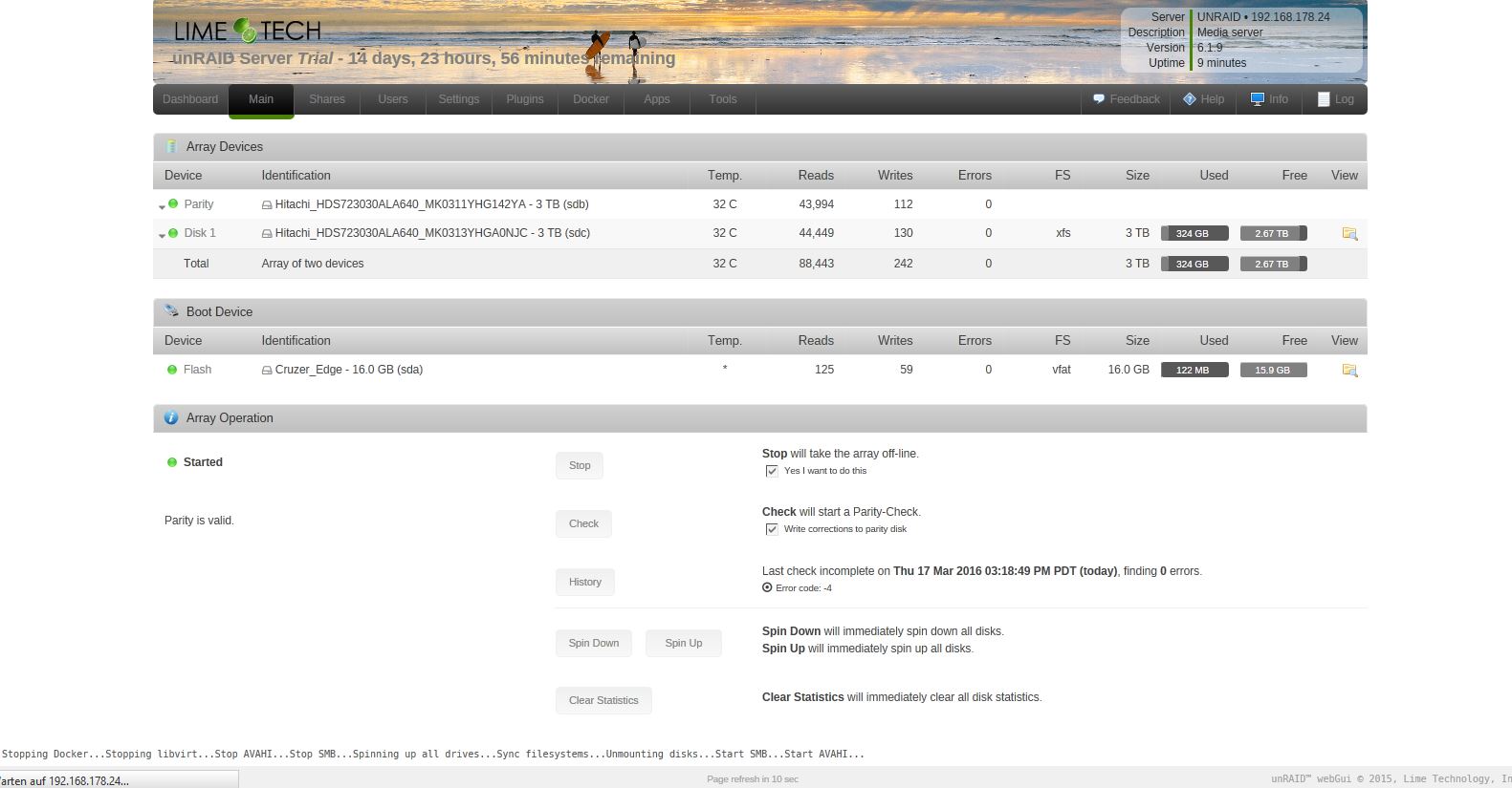

Just tryd to stop the array and the UI freeze. I add the picture to this post...
Look at the the bottom right-center side of the screen capture.  It says "Screen refresh in 10 Sec".  Think that might make the GUI appear to be frozen and/or slow???
Do you have issues on other GUI tabs and what does it say in that spot?
"Screen refresh in 10 Sec" is showing because i set screen refresh time from real-time to regular. Countdown starts alway new but nothing happend. UI is still unresponsive. Only if i press the "help" Button, help pops up. Popups like Info dos´n work. I think there is no commection to the Unraid Server. Next Problem is that the power switch on the server also dosn´t work when the system hangs. How can i shut down the Server savely via command line? I tried the shutdown command at the console but i don´t know how are the parameters have to be.
