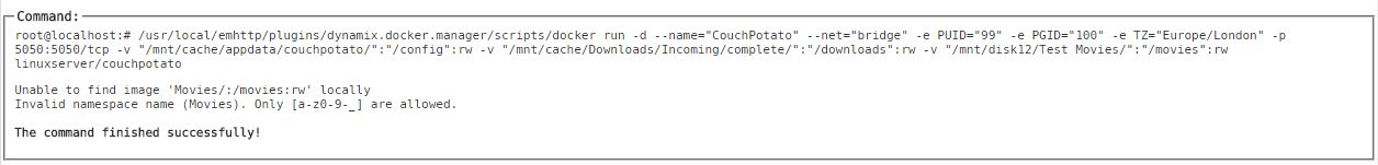

Hi folks,
I've been having issues with setting up a new container - every time I try and add either couchpotato or sonarr, it just ends up adding an orphan - both seem to have some kind of problem adding the folder with movies/tv in. I've already tried stopping docker, delting the img (I was having some btfrs issues that the scrub couldn't fix...).

Plugins - Check for updates.  Install the WebUI update that'll be available
Thank you so much Squid! I was having the same problem, and this resolved it.
worked for me too, thanks squid
