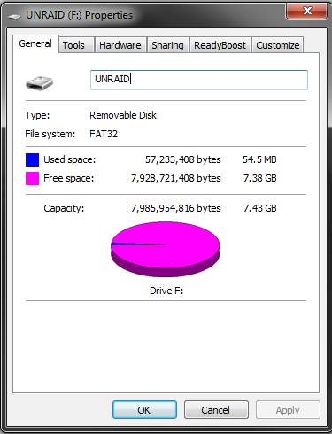

I check the format for FAT32
Volume label is UNRAID
I even tried using diskpart to reset the device as much as possible.

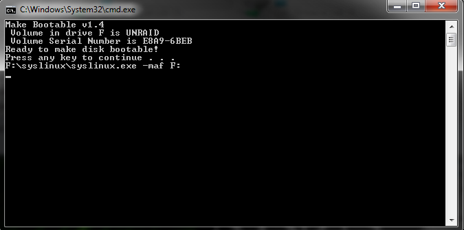

Every time i run mack_bootable.bat (windows 7) and press the key to continue, it just stops. I have waited over an hour for it to complete with no luck.

Can you confirm that you ran make_bootable.bat as Administrator by right clicking on it and selecting the 'Run as Administrator' option.

Yea ran as administrator. Also i am the only admin on this PC so its not user group issues either.
Just Tried with 2 different USB drives in both FAT and FAT32 formats with same result
