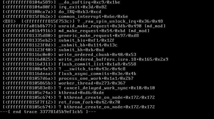

Hi Guys,
Would a failed drive, in this case 2 failed drives not assigned to the array, cause crashing?  When booting the server I get SMART errors on 2 of my drives that were no assigned.  I restarted the server into UNRAID twice and each night the server crashes.  Today I removed both drives and then ran a memory test, which passed.  Is it as simple as the drives causing this failure?  Also, no errors show int he log from the gui that I checked.  Thanks for your help!

Define daily crash? I'd also highly recommend posting up a diagnostic file.
Hi Kizer.  Sure and thanks!  Sometime between the time I go to bed and wake up the system freezes, probably better term than crash.  To the point that I am not able to login via root or even connect via telnet.  One thing I have not been able to tell is what the screen displays when it freezes.  I have connected a monitor so I can get a visual if it happens again.  I have connected the diagnostics zip.  Thanks for looking at this.

As johnnie predicted, it failed. So you need to replace it.
Thanks guys.  I will get to work on the replacement of SATA cables and drives and then see where I stand.  Bummer I am losing so many drives....they are getting old though.
Quick update.  The server froze again last night.  I have not made any changes to the cache drive yet bud did pull the 2 failed drives.  Understanding that I have some hardware issues.... there must also be something running in the middle of the night that is causing this?  Could it be the CRON job?  I was able to grab this screenshot before I restarted the server this morning.  Does this make sense to anyone?
I am going to disable all of my dockers and cache drive for now.  Hoping to stop the freezing.
Do you have the mover running at night?
Since the cache disk is bad it could be reason for the crash.
Bingo! I agree with JB... I had this exact same issue several month back. Bad cache drive being written to in the middle of the night and every morning when I woke up,  my server was toast and unusable every single morning. I hope your troubles get solved quickly. Unraid is an awesome powerhouse when it all runs as designed. Good luck!
Yep, I sure do!  This makes perfect sense.  I have changed the mover to run monthly.  This should buy me enough time to swap out the drive.  Not looking forward to the long process of clearing the new drive.
Agreed that unRAID is great.  I am very happy with it, especially with my plex, tv and home automation needs.
Thanks again for your help guys!
No crash this morning.  Thanks again.
