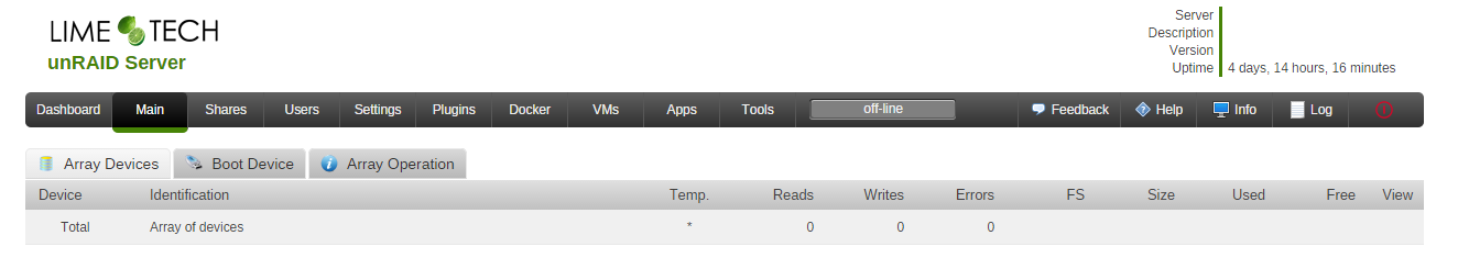

Docker won't start and my logs are spammed with these messages. Been like this for hours. Any help would be greatly appreciated.
Mar 24 11:08:33 Tower root: starting docker ...
Mar 24 11:08:34 Tower emhttp: shcmd (240): /etc/rc.d/rc.libvirt start |& logger
Mar 24 11:08:34 Tower root: no image mounted at /etc/libvirt
Mar 24 11:08:36 Tower root: mount: /mnt/cache/docker.img is already mounted
Mar 24 11:08:36 Tower root: mount error
Mar 24 11:08:36 Tower emhttp: shcmd (250): /etc/rc.d/rc.docker start |& logger
Mar 24 11:08:36 Tower root: starting docker ...
Mar 24 11:08:36 Tower emhttp: shcmd (253): /etc/rc.d/rc.libvirt start |& logger
Mar 24 11:08:36 Tower root: no image mounted at /etc/libvirt
Mar 24 11:09:01 Tower root: mount: /mnt/cache/docker.img is already mounted
Mar 24 11:09:01 Tower root: mount error
Mar 24 11:09:01 Tower emhttp: shcmd (263): /etc/rc.d/rc.docker start |& logger
Mar 24 11:09:01 Tower root: starting docker ...
Mar 24 11:09:01 Tower emhttp: shcmd (266): /etc/rc.d/rc.libvirt start |& logger
Mar 24 11:09:01 Tower root: no image mounted at /etc/libvirt
Mar 24 11:10:01 Tower root: mount: /mnt/cache/docker.img is already mounted
Mar 24 11:10:01 Tower root: mount error
Mar 24 11:10:01 Tower emhttp: shcmd (276): /etc/rc.d/rc.docker start |& logger
Mar 24 11:10:02 Tower root: starting docker ...
Mar 24 11:10:02 Tower emhttp: shcmd (279): /etc/rc.d/rc.libvirt start |& logger
Mar 24 11:10:02 Tower root: no image mounted at /etc/libvirt
Mar 24 11:11:01 Tower root: mount: /mnt/cache/docker.img is already mounted
Mar 24 11:11:01 Tower root: mount error
Mar 24 11:11:01 Tower emhttp: shcmd (289): /etc/rc.d/rc.docker start |& logger
Mar 24 11:11:01 Tower root: starting docker ...
Mar 24 11:11:01 Tower emhttp: shcmd (292): /etc/rc.d/rc.libvirt start |& logger
Mar 24 11:11:01 Tower root: no image mounted at /etc/libvirt
Mar 24 11:12:01 Tower root: mount: /mnt/cache/docker.img is already mounted
Mar 24 11:12:01 Tower root: mount error
Mar 24 11:12:01 Tower emhttp: shcmd (302): /etc/rc.d/rc.docker start |& logger
Mar 24 11:12:01 Tower root: starting docker ...
Mar 24 11:12:01 Tower emhttp: shcmd (305): /etc/rc.d/rc.libvirt start |& logger
Mar 24 11:12:01 Tower root: no image mounted at /etc/libvirt
Mar 24 11:12:10 Tower root: mount: /mnt/cache/docker.img is already mounted
Mar 24 11:12:10 Tower root: mount error
Mar 24 11:12:10 Tower emhttp: shcmd (315): /etc/rc.d/rc.docker start |& logger
Mar 24 11:12:10 Tower root: starting docker ...
Mar 24 11:12:10 Tower emhttp: shcmd (318): /etc/rc.d/rc.libvirt start |& logger
Mar 24 11:12:10 Tower root: no image mounted at /etc/libvirt
