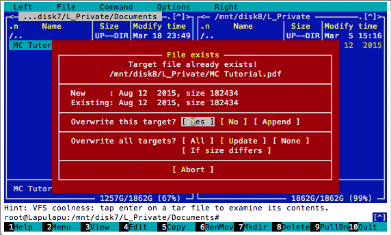

If I'm using MC and copying files from disk1 to disk2, and disk2 has some of these files, will this just create an overwrite?
I know I'm transferring some duplicates, but I've yet to see anything regarding "would you like to overwrite".
It will give you the opportunity to decide whether to overwrite or skip.
Edit: added example picture.
