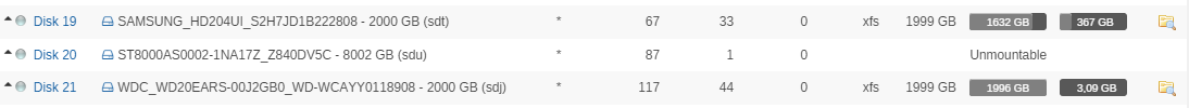

The rebuild is done but the disk appears as unmountable.
What did I do wrong ?

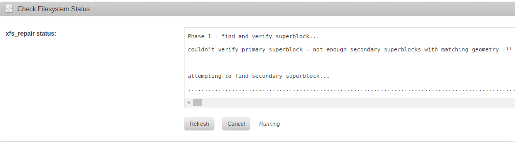

Phase 1 - find and verify superblock...
couldn't verify primary superblock - not enough secondary superblocks with matching geometry !!!
attempting to find secondary superblock...
.....................with a lot of dots.........
The check is done and I don't seem to have any more hint on what to do.
......a million dots....
unable to verify superblock, continuing...
..... a Billion dots.....
Exiting now.
Should I try to repair ?

I just pressed the button [Check] in the Check Filesystem Status of the very disk.
The option seems to be -n

In that case something went wrong during the rebuild, as xfs_repair is not finding a valid filesystem to repair.

I tried to launch the xfs_repair.
do you think it is premature ?
Should I cancel it ?
The -n option indicates a trial run, a read-only check of the file system.  To actually make fixes, you have to remove the -n.  (You may have already figured that out.)

Yes, the new disk was unmountable from the beginning of the rebuild.
In this case it was always going to stay unmountable at the end of it.
My parity was valid but maybe the corrupted filesystem was also in the parity.
A common misconception about parity is that it has some idea of what data is any particular file.  Actually parity knows nothing about the data on a disk, and it does not even know what type of file system you have there.  All it knows is how to put a any particular sector back to how it thinks it should be.    Therefore if you have corruption before you start a rebuild it will always still be there afterwards.

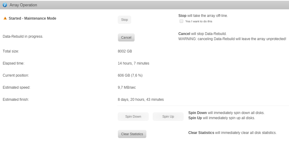

As I stated a few hours ago, I started the xfs_repair on the new drive (seagate 8TB) in the array.
I am surprised to see that the main page is stating a rebuild.
It will take a while and if the rebuild s the same as the first one, it will not change anything.

A rebuild would normally never start on its own.
You shouldn't be doing a rebuild and xfs_repair at the same time, both operations will slow down considerably especially because you trying to repair the emulated disk.

I didn't ask or press anything for the rebuild
I pressed the button for xfs_repair, that's all.
Should I stop the rebuild ?
