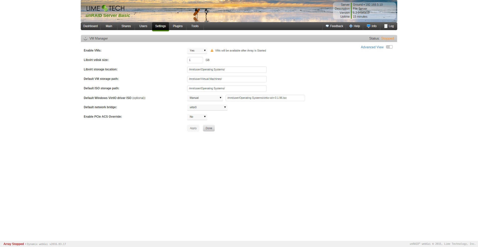

March 20, 201610 yr Author Attached will be the screenshot of what I see. All of the file paths should be right with the status in the top right. My array is started I just took the picture before it was. After checking it didn't make a difference whether it was or not as the status still said disabled either way.
March 20, 201610 yr I changed the iso and vm image locations but I left the libvirt location unchanged and set as mnt/user/system/libvirt/libvirt.img (which ends up on the cache disk as the 'system' share is set as cache only. It might be worth leaving yours at that to see if it makes a difference. I think the VM settings from 6.1.9 are auto-migrated to that location.

March 21, 201610 yr Author Fixed it. libvirt.img cannot be anywhere other than /mnt/cache/libvirt.img even if you put it in a folder that /is/ the cache drive. It must specifically be that exact path. Once I make it /mnt/cache/libvirt.img the status changes.
March 21, 201610 yr Fixed it. libvirt.img cannot be anywhere other than /mnt/cache/libvirt.img even if you put it in a folder that /is/ the cache drive. It must specifically be that exact path. Once I make it /mnt/cache/libvirt.img the status changes. Well mine is at /mnt/user/system/libvirt/libvirt.img which is where the upgrade process put it and that works fine for me. Since the 'system' share is set as cache only that is a the same as /mnt/cache/system/libvirt/libvirt.img
March 21, 201610 yr Author Fixed it. libvirt.img cannot be anywhere other than /mnt/cache/libvirt.img even if you put it in a folder that /is/ the cache drive. It must specifically be that exact path. Once I make it /mnt/cache/libvirt.img the status changes. Well mine is at /mnt/user/system/libvirt/libvirt.img which is where the upgrade process put it and that works fine for me. Since the 'system' share is set as cache only that is a the same as /mnt/cache/system/libvirt/libvirt.img /mnt/user/Virtual Machines/libvirt.img is also cache only and didn't work for me so it's strange you had better luck than me. At least future users upgrading can look into this thread in case they run into similar and use what we've both experienced.
March 21, 201610 yr Fixed it. libvirt.img cannot be anywhere other than /mnt/cache/libvirt.img even if you put it in a folder that /is/ the cache drive. It must specifically be that exact path. Once I make it /mnt/cache/libvirt.img the status changes. Well mine is at /mnt/user/system/libvirt/libvirt.img which is where the upgrade process put it and that works fine for me. Since the 'system' share is set as cache only that is a the same as /mnt/cache/system/libvirt/libvirt.img /mnt/user/Virtual Machines/libvirt.img is also cache only and didn't work for me so it's strange you had better luck than me. At least future users upgrading can look into this thread in case they run into similar and use what we've both experienced. It is probably the space in the folder name that was the fault. I guess you only tried with a folder that contained a space? If that is the case you should post it in the beta thread so limetech is aware of the bug.
