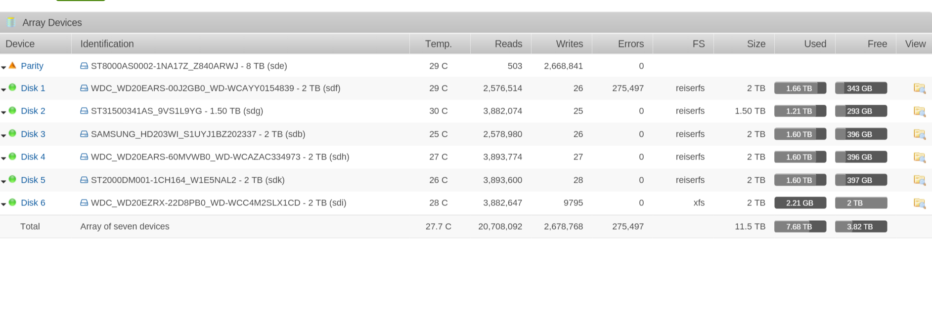

Woke up this morning and a third drive is failing, the parity is @12.5% and is running very slow.
Should i stop the parity and try to move data from the failing disk to the new disk ?
Attached print screen, syslog and smart.

Mar 26 10:23:44 Tower_Oron kernel: ata5.00: exception Emask 0x0 SAct 0x0 SErr 0x0 action 0x0
Mar 26 10:23:44 Tower_Oron kernel: ata5.00: irq_stat 0x40000001
Mar 26 10:23:44 Tower_Oron kernel: ata5.00: failed command: READ DMA EXT
Mar 26 10:23:44 Tower_Oron kernel: ata5.00: cmd 25/00:40:ef:72:1a/00:05:76:00:00/e0 tag 18 dma 688128 in
Mar 26 10:23:44 Tower_Oron kernel:        res 51/40:2f:f7:76:1a/00:01:76:00:00/e0 Emask 0x9 (media error)
Mar 26 10:23:44 Tower_Oron kernel: ata5.00: status: { DRDY ERR }
Mar 26 10:23:44 Tower_Oron kernel: ata5.00: error: { UNC }
Mar 26 10:23:44 Tower_Oron kernel: ata5.00: configured for UDMA/133
Mar 26 10:23:44 Tower_Oron kernel: sd 6:0:0:0: [sdf] tag#18 UNKNOWN(0x2003) Result: hostbyte=0x00 driverbyte=0x08
Mar 26 10:23:44 Tower_Oron kernel: sd 6:0:0:0: [sdf] tag#18 Sense Key : 0x3 [current] [descriptor]
Mar 26 10:23:44 Tower_Oron kernel: sd 6:0:0:0: [sdf] tag#18 ASC=0x11 ASCQ=0x4
Mar 26 10:23:44 Tower_Oron kernel: sd 6:0:0:0: [sdf] tag#18 CDB: opcode=0x28 28 00 76 1a 72 ef 00 05 40 00
Mar 26 10:23:44 Tower_Oron kernel: blk_update_request: I/O error, dev sdf, sector 1981445879
Mar 26 10:23:44 Tower_Oron kernel: ata5: EH complete
Mar 26 10:23:44 Tower_Oron kernel: md: disk1 read error, sector=1981445816
Mar 26 10:23:44 Tower_Oron kernel: md: disk1 read error, sector=1981445824
Mar 26 10:23:44 Tower_Oron kernel: md: disk1 read error, sector=1981445832
Mar 26 10:23:44 Tower_Oron kernel: md: disk1 read error, sector=1981445840
Mar 26 10:23:44 Tower_Oron kernel: md: disk1 read error, sector=1981445848
Mar 26 10:23:44 Tower_Oron kernel: md: disk1 read error, sector=1981445856
Mar 26 10:23:44 Tower_Oron kernel: md: disk1 read error, sector=1981445864
Mar 26 10:23:44 Tower_Oron kernel: md: disk1 read error, sector=1981445872
Mar 26 10:23:44 Tower_Oron kernel: md: disk1 read error, sector=1981445880
Mar 26 10:23:44 Tower_Oron kernel: md: disk1 read error, sector=1981445888
Mar 26 10:23:44 Tower_Oron kernel: md: disk1 read error, sector=1981445896
Mar 26 10:23:44 Tower_Oron kernel: md: disk1 read error, sector=1981445904
Mar 26 10:23:44 Tower_Oron kernel: md: disk1 read error, sector=1981445912
Mar 26 10:23:44 Tower_Oron kernel: md: disk1 read error, sector=1981445920
Mar 26 10:23:44 Tower_Oron kernel: md: disk1 read error, sector=1981445928
Mar 26 10:23:44 Tower_Oron kernel: md: disk1 read error, sector=1981445936
Mar 26 10:23:44 Tower_Oron kernel: md: disk1 read error, sector=1981445944
Mar 26 10:23:44 Tower_Oron kernel: md: disk1 read error, sector=1981445952
Mar 26 10:23:44 Tower_Oron kernel: md: disk1 read error, sector=1981445960

WDC_WD20EARS-00J2GB0_WD-WCAYY0154839-20160326-1027.txt
That's some bad luck  :'(
Disk1 is bad, lots of pending sectors.
-since you have enough space I would cancel the parity sync, stop array, unassign parity for now and start array.
-copy everything you can from disk1 to another disk.
-when done do a new config without disk1 (or use a spare in its place if you have one) and start new parity sync.
Finished salvaging what oi can from the third HDD.
Now i need to do new config again, we the replacement HDD instead of the third HDD and the new parity ?
Use all disks except old disk1, after doing the new config and starting the array a new parity sync will begin.
It will do a new parity from the start? i started a bad parity build with the new parity drive, i'm afraid it will do me some damage...
