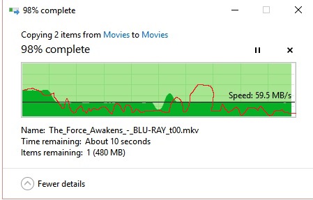

Ok... So I really think the Reiserfs formatting must be the culprit. I just transferred a movie to an XFS drive and attached below is what the graph looked like this time. (I drew a red line to show what I was seeing before)
Much more stable and consistent. Other than one little dip/peak around the 50% mark it maintained 60MB/s (+/- 3MB/s) throughout.  Next time I'll try terracopy and see if that has any noticeable effect. In the meantime, I'll probably have to get started on converting to XFS. hahaha
