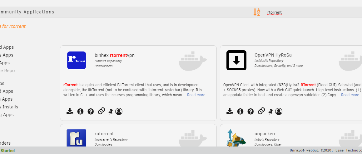

Hello, it seems this docker is not working anymore. I installed it from Plugins menu. It wont connect to WebUI. I didnt change any settings. Is this stil active docker or we need to install something else?
No you didn't  because it's not a plugin. You will have to tell us more.
See the first post in the Docker FAQ and the first post in this thread.
Well i downloaded from here, it says Community Applications:
I go to Docker tab on my unraid screen, I click on blue picture next to name: binhex-rtorrentvpn and then click WebUI. It opens new tab saying http://192.168.1.99:9080/. Saying it cant load webpage ERR_CONNECTION_REFUSED
Network:
Bridge
Port Mappings:
172.17.0.2:5000/TCP <-> 192.168.1.99:5000
172.17.0.2:8118/TCP <-> 192.168.1.99:8118
172.17.0.2:9080/TCP <-> 192.168.1.99:9080
172.17.0.2:9443/TCP <-> 192.168.1.99:9443
Volume mappings:
/data <-> /mnt/user/appdata/data
/config <-> /mnt/user/appdata/binhex-rtorrentvpn
I checked links in first post, it redirect me to some websites with files. I dont know what to do there.... Am i sopouse to copy something from there?
Edited by Roketta
Network:
Bridge
Port Mappings:
Volume mappings:
Post your logs, redacting your username/password for your VPN provider.
