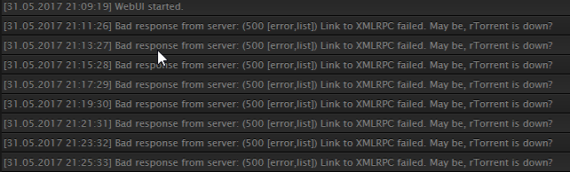

Hello, I've been experiencing an odd issue that others have experienced before but I can't seem fix it. RuTorrent seems to lose connection with rTorrent (rTorrent child process quits) as soon as all the torrents are loaded, checked, and immediately (within 3 seconds) of establishing a connection to any peer. The RuTorrent WebUI and functionality works perfectly fine until a connection to a peer is created and the rTorrent process immediately quits (I think). I've been using the Docker for months with VPN enabled without encountering this issue, so I can only conclude it must be correlated to the environment variable of where the internal VPN is disabled as experienced by user MyKroFt in this post but was apparently resolved in an update?
I have tried using both non-privileged and privileged mode for the docker and disabling the external OpenVPN plugin.
I'm currently running rTorrentVPN in default configuration with the VPN_ENABLED option set to false as I'm running the OpenVPN Client Plugin as I'm trying resolve an issue with rTorrentVPN not downloading with the built-in OpenVPN running on Arch. I'm not 100% sure that OpenVPN Client Plugin is causing this error as DelugeVPN shows no issues with torrenting while the external VPN is enabled.
Supervisor Log with DEBUG Enabled (no confidential info):
https://pastebin.com/HPwiXY6M
Edited by 1stHyperion

That looks like issues with a plugin(s), stop the container and delete '/config/rutorrent/plugins' folder and then start the container again.

Thank you very much BinHex :D
Deleted the Plugins folder and restarted the Docker twice and it now works great.
