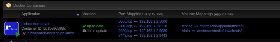

@binhex On your github docker page for this docker it shows the following for openvpn config.
Stop rtorrentvpn docker and copy the saved ovpn file to the /config/openvpn/ folder on the host
But the path is simply /openvpn. On my system it shows it as /mnt/user/appdata/binhex-rtorrentvpn/openvpn
It seems to be working though as far as VPN and port forwarding goes, I'll test integration with other apps soon.
Edited by Tuftuf
those instructions assume you are using the correct volume mappings, which by the look of it you aren't, the docker run example on github shows the volume mappings:-
docker run -d \
    --cap-add=NET_ADMIN \
    -p 9080:9080 \
    -p 9443:9443 \
    -p 8118:8118 \
    -p 3000:3000 \
    --name=<container name> \
    -v <path for data files>:/data \
    -v <path for config files>:/config \
    -v /etc/localtime:/etc/localtime:ro \
so you should have a volume mapping for /data and a volume mapping for /config
edit - keep in mind the path on the host side can be anything you want but you MUST use the correct volume names on the container side, as in 'config' and 'data'
Edited by binhex
I understand where the difference is now.
I was looking for a /config folder within bixhex-rtorrentvpn instead of making the connection in my head that /config actually means /mnt/user/appdata/binhex-rtorrentvpn
I did use the default mapping of /config but I was looking to access the folder via the unraid system to just copy the ovpn file, and that path is, of course, the path I set to be linked to /config within the container.
Edited by Tuftuf
