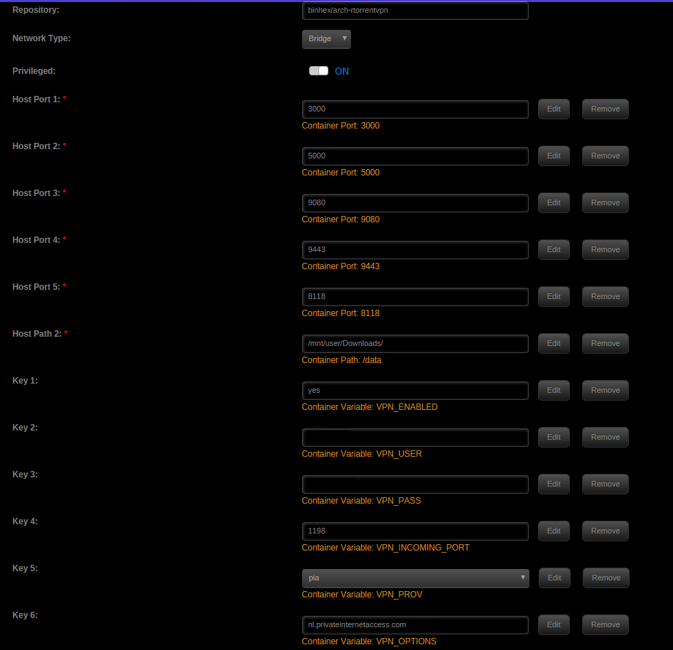

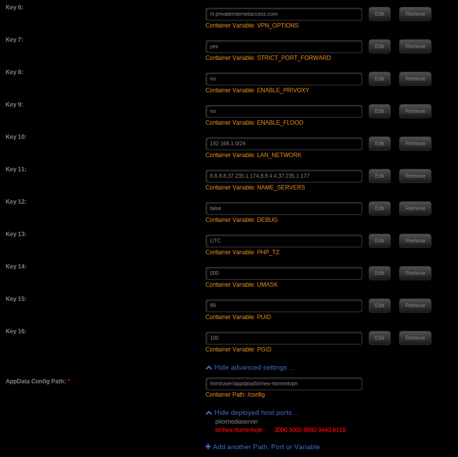

Hi
Have been trying for a awhile now to get this docker going and im not having any luck. Hope someone here can see what i have done wrong.
supervisord.log
10 minutes ago, Kevin111 said:
Hi
supervisord.log
VPN_OPTIONS is used to define additional advanced openvpn command line options, not sure why you thought the vpn remote endpoint goes there?
VPN_OPTIONS defined as 'nl.privateinternetaccess.com'
remove this and you should be good.
