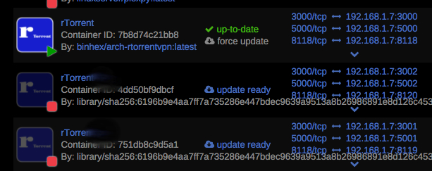

Is this expected behavior?
I have several instances of this docker and when I update one, this immediately shows on the others. When I update the remaining instances, nothing gets pulled and they update without issue. Curious as to what is going on. Otherwise, the docker works great and all work wonderfully.
Completely expected, not sure why you have multiple containers defined though for the same image.
Sent from my SM-G935F using Tapatalk
I'm not certain of the correct terminology for containers/docker/images. Do I have my ports set up properly so each container is operating independently? I have multiple containers because I was told that rutorrent can only handle 3,500-6000 torrents before the webgui stops working properly. I don't have nearly that many now but I separated TV, Movies and books into their own container because it is not out of the question that I would start to push the upper limits of what rutorrent can handle.
ahh yes thats fine, your ports looks good to me, just make sure you have a separate /config path for each as well right. im not sure of the limits for rutorrent, but i thought it was higher than that, more like 20,000 but i might be wrong.
