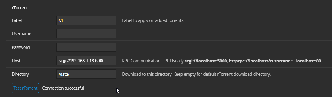

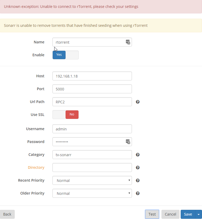

looking for a bit of help getting this to communicate nicely with sonar and CP if I could. At present to start with CP... it will test just fine but wont add torrents after snatching them. With sonarr i just cant get it to communicate at all. If you can help at all that would be great. I can manually add torrents and they work just fine.
EDIT
Sonarr was tried with and without username and PW. just took the pic like that.
Edited by tazire
EDIT
this is what sonarr to rtorrentvpn should look like:-
https://github.com/binhex/images/blob/master/docker/config/sonarr-rtorrent.png
the port i have specified in the screenshot is my own port (1710) so its whatever you have mapped for the web interface, NOT for port 5000
Edited by binhex

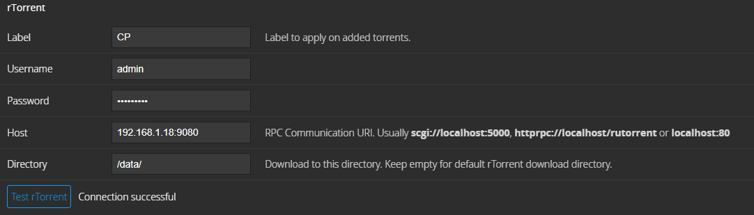

ok perfect.... that worked with sonarr.
Thanks the same settings appear to have worked on CP too. Thanks for that

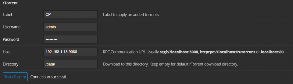

EDIT...
Still the same problem on CP. Test successful but  still wont add snatched downloads. Any ideas?
Edited by tazire
On 3/23/2018 at 10:17 AM, tazire said:
EDIT...
If I had to guess, I would say its a permissions issue on the rtorrent side... check the logs, most likely its unable to save the torrent to the rtorrent/session directory or something.
I managed to fix this. It took a full rebuild of each container to get there but I did.... having other issues now though.... first of all the automover seems a bit selective and then sonarr and couchpotato just arent dealing with the files properly once downloaded.... I have had to manually import most downloaded files in sonarr.
Strangely the first 4 torrents downloaded and were handled perfectly but since then its just been a bit of a mess....
