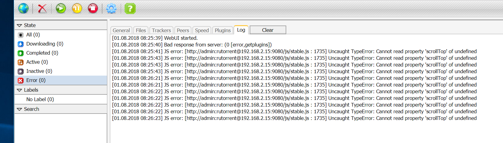

Hello,
I've noticed random crashes over the last couple of months.
It's hard to find a trend, the closest I got is if I add a torrent it will timeout on rutorrent (not all torrents do this).
2018-06-21 09:04:22,988 DEBG 'rutorrent-script' stderr output:
2018/06/21 09:04:22 [error] 3103#3103: *7386 FastCGI sent in stderr: "PHP message: PHP Notice: Undefined offset: 3 in /usr/share/webapps/rutorrent/plugins/extratio/rules.php on line 198" while reading response header from upstream, client: 192.168.1.122, server: localhost, request: "POST /plugins/extratio/action.php HTTP/1.1", upstream: "fastcgi://127.0.0.1:7777", host: "192.168.1.110:9080", referrer: "http://192.168.1.110:9080/"
2018-06-21 09:04:25,731 DEBG 'rutorrent-script' stderr output:
2018/06/21 09:04:25 [error] 3103#3103: *7387 FastCGI sent in stderr: "PHP message: PHP Notice: Undefined offset: 3 in /usr/share/webapps/rutorrent/plugins/extratio/rules.php on line 198" while reading response header from upstream, client: 192.168.1.122, server: localhost, request: "POST /plugins/extratio/action.php HTTP/1.1", upstream: "fastcgi://127.0.0.1:7777", host: "192.168.1.110:9080", referrer: "http://192.168.1.110:9080/"
I try to restart the container. although there are no errors that it still times out

I'm not able to access the web UI. I have LAN_NETWORK set correctly so I'm not sure what's going on.
Log:
Created by...
Log:
you are probably seeing issues relating to the change in rtorrent.rc, do the following:-
1. stop the container
2. delete the file /config/rtorrent/rtorrent.rc
3. start the container.
That did it. Thanks mate. (deleted my other thread)
Now that I have it up and running again I'm getting errors any time I click anything in the UI.

When I move the persistent data folder, to let the container create a new folder, after adding the vpn configs, it actually loads all the way. There has to be something else wrong. I'm going to stop troubleshooting for now, until I get some more advice :)
Edited by bumperjeep
I'm using this to connect to my seedbox that also offers me a VPN. I've got it to mostly work, but it shows the port I've selected for rtorrent is closed. I can download things and my tracker shows it is from the VPN ip, but my tracker is telling me "Client can not accept incoming connections."
My seedbox provider said their ports are all open by default, and this is an issue on my end.
I don't really know what I'm doing though, I'm sure I'm missing something simple.
Can anyone point me in the right direction?
