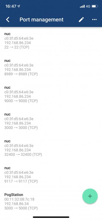

1. do you use vlan's on your home network? - if so then check that the vlan assigned to the host allows inbound and outbound external access and the routing is correct.
Not as far as I know. I have it working fine on a Synology which shares the same network.
2. is a firewall running on your host? - check to see if anything is blocking outbound on the host, if you are running all the containers on the same host and you have external access to them, then this wont be the issue.
I'm running non-VPN containers and remotely connecting to them without problems on the same device.
3. does 192.168.86.0/24 cover all networks on your lan? - if it doesn't then you will need to add in any additional networks you have defined, what is your router's ip address?
The IP addresses are 192.168.86.* The router's IP address is 192.168.86.1.

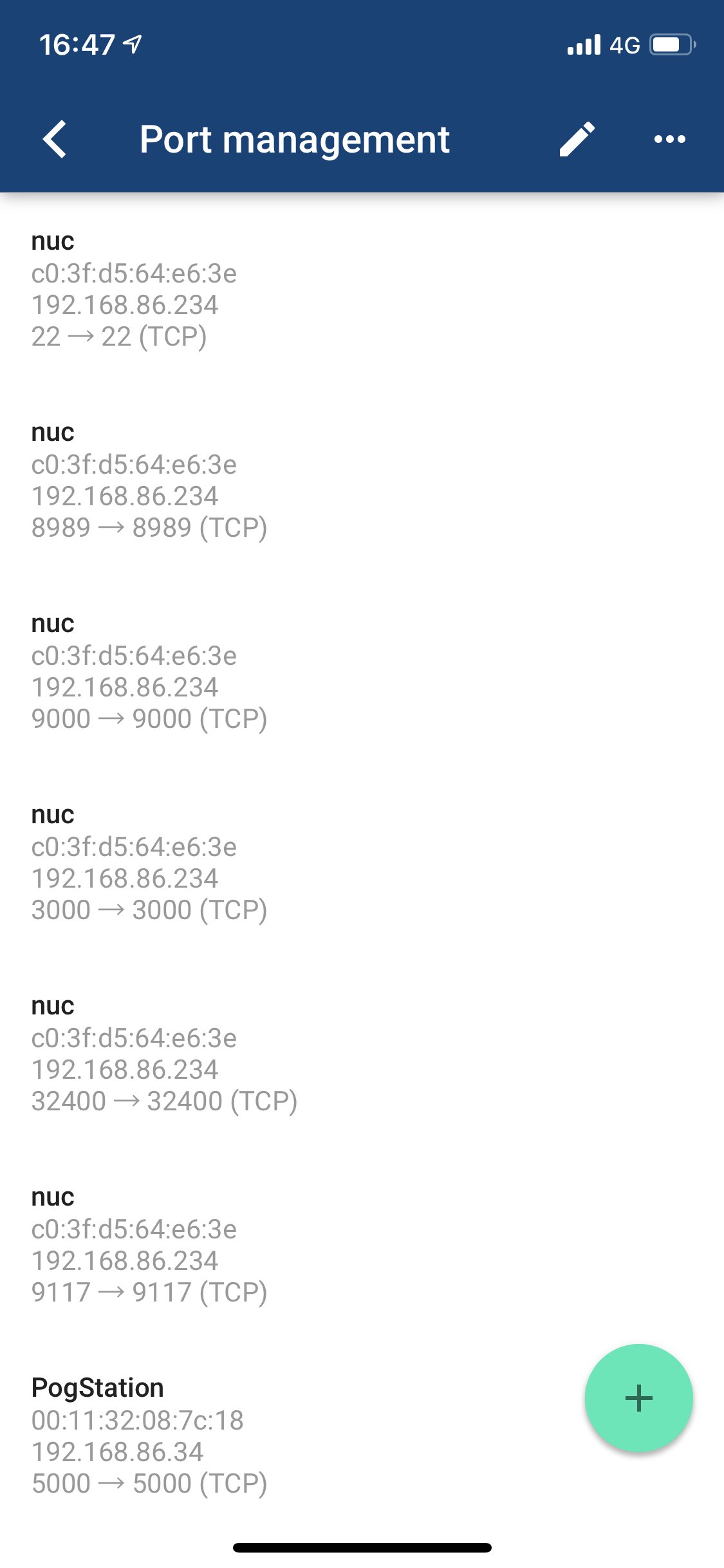

4. port forwarding - can you post a screenshot showing how you have defined the port forward for this container?, it should be port forward to internal ip 192.168.86.xxx where xxx is your hosts ip, and port <host port you have chosen for flood, normally 3000>
I've attached a screenshot showing the port forwarding I'm using and a log file with debug enabled. After your post I noticed that I was setting debug to true but then false later in the YML - sorry about that.
To recap, neither DelugeVPN or rTorrentVPN can be accessed remotely. Both can be accessed locally. I previously had these containers running on a Synology on the same network, so I'm inclined to say it's not my network. Ports are correctly forwarded, as far as I can see. This is the first time I'm running on Ubuntu Server, so perhaps I've set something incorrectly there.
I assume that the IP I should be connecting to is the same as my WAN IP? That's what I did successfully on the Synology.
supervisord.log
Edited by DavidAUK
Re=uploaded log file.
And I don't know if it provides a clue or not, but when I'm on the home LAN and use the WAN IP on the VPN containers then everything works fine. That would suggest that I have the right IP and ports at least.
Also, online port forward testers think that my the ports on my VPN containers are closed.
Edited by DavidAUK
Re-uploaded the log file. iptable_mangle seems to be working but still no success accessing rtorrentvpn on delugevpn remotely.
Edited by DavidAUK
