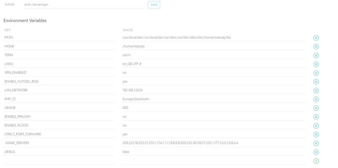

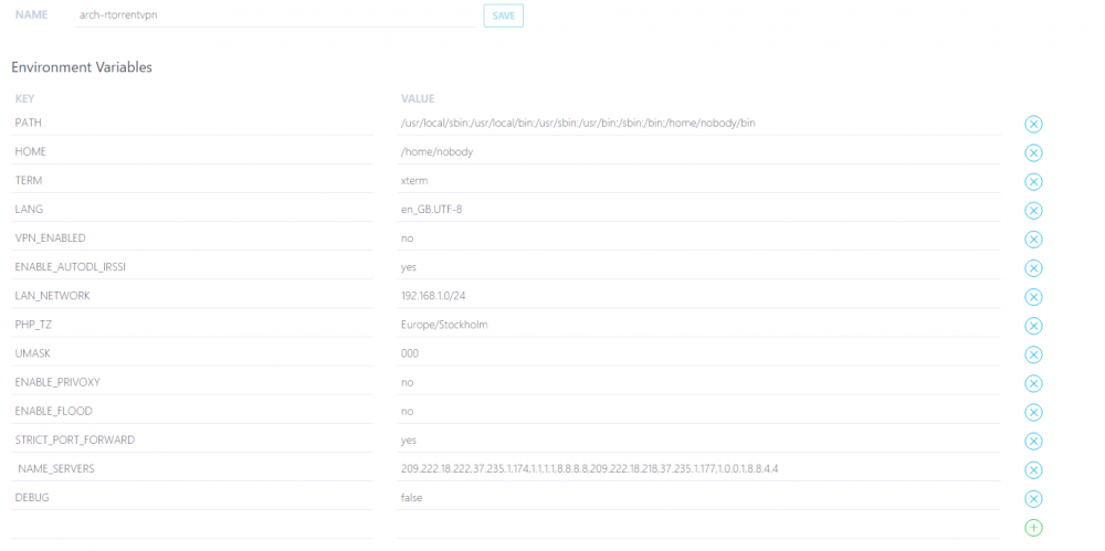

How do I get Flood frontend working?
I set ENABLE_FLOOD to yes in docker settings.
Some thing about preventing rutorrent from starting since Flood is enabled in log. Docker start without any problem.
No webinterface at all at port 9080 anylonger. Am I doing this wrong?
Edit:
Ok changed to "no" and now Im not even get rutorrent interface back.
Have restarted docker several times :(
NO idea what could have been messed up by just changing the variable from no to yes and then back to no
Edited by Johan76
Stopped working at all

Flood listens in port 3000.
Rutorrent listens in port 9080 and 9443 (Https).
If you want both you can set ENABLE_FLOOD to BOTH.
Be warned that, while it looks great, flood uses a lot of memory and is not as feature complete as rutorrent. With 1k torrents Flood's Node.js process is using quite a bit of memory, plus the UI lags so much that it's barely usable; Rutorrent is still doing "reasonably" fine.
As for rutorrent not starting, try to start from scratch. Delete the container, pull the latest image and start with a fresh volume / host folder bound to the container's /config folder.
Edited by Cat_Seeder

Got it working by removing as you said.
Had to remove everything and choose enable flood. Then flood work.
Cannot switch between flood/rutorrent just by changing variable and restarting docker. Need to remove everything between switches. However I found out I preferred rutorrent so switched back [emoji4]

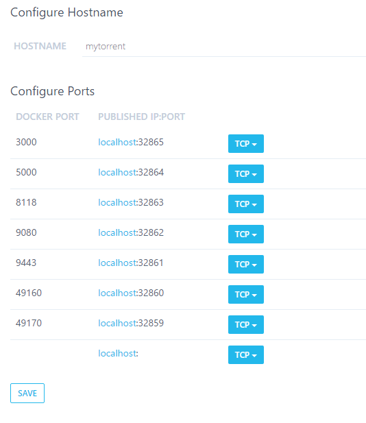

Bare with my I am quite new to docker. I have a problem that I am not sure how to fix. I have searched the internet but cannot really seem to fix it. So I am using Kitematic for windows because I find it easy with a GUI to handle the containers. I downloaded rtorrentvpn. I used the following values (see image). The ports were set automatically. I have understood that you must publish port in order to access container from outside the network and this seems to be in placed when i look in the output of the "Docker inspect ..." command. But I only want to access it from within my own network but from another device, so over wifi for example. I wouldnt mind to access it from outside aswell but then I have to make my host reachable.
So I can access the rtorrent through http://localhost:32862/
but I cannot access it through host ip as said in the guide from another device connected to the same network. I cannot even access it with this address from the host:
http://<host ip>:9080/
I have replaced host ip with my computers ip from https://www.myip.com/. I have also tried 192.168.99.100:9080, which i found online that is the default docker machine. I am not sure how to access rtorrent with host ip, can anyone please help me?
Please keep in mind all this is new to me.
Kitematic_2019-03-14_22-05-44.thumb.png.9b12def5841b5145cc3c41b7ad09d9d3.pngKitematic_2019-03-14_22-05-57.png.91981a9769f6453e2404173488080ce5.png
Edited by geoyil

I would probably drop Kinematic all together and go native (e.g., Docker Desktop). I'm not familiar with Kitematic, but it seems to be binding ports to localhost only (e.g. -p 127.0.0.1:32862:9080 instead of -p 9080:9080).
The CLI is not that hard to learn; plus not having to deal with Docker Toolbox / VirtualBox will make your life easier.

I did this, It works fine thank you.
Another question, I wanted to try with VPN and I was successfull to access the webui for rtorrents. I am using a custom one, ProtonVPN. They have a free one I wanted to just try with. Anyway my problem is that the torrents are sometimes not downloading, they are red (error). I am trying to download the Ubuntu torrent from the official page so I know it is not the torrent because I tried this without VPN (worked great). Sometimes the torrent is red (error) but still downloading..
It does say in the bottom of rutorrent that "6881: Port status is unknown"
What is wrong here and what do I need to do?
