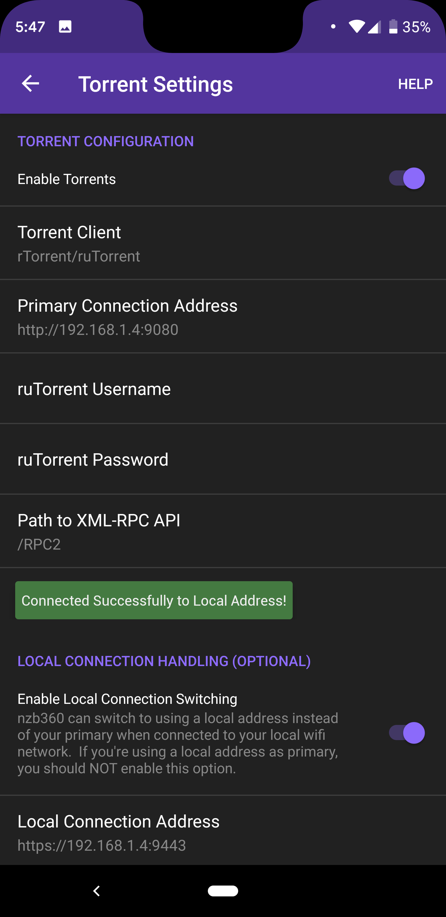

29 minutes ago, BrttClne22 said:
Within my network, I've currently got NZB360 (an android app) pointed at https://192.168.1.4:9443/RPC2 (ports are all default) and it's working with no username or password.
i also use nzb360 and for me it will not allow me to connect to rutorrent via rpc2 without authentication details (as in ruTorrent username and password), do you have authentication enabled for the web ui?

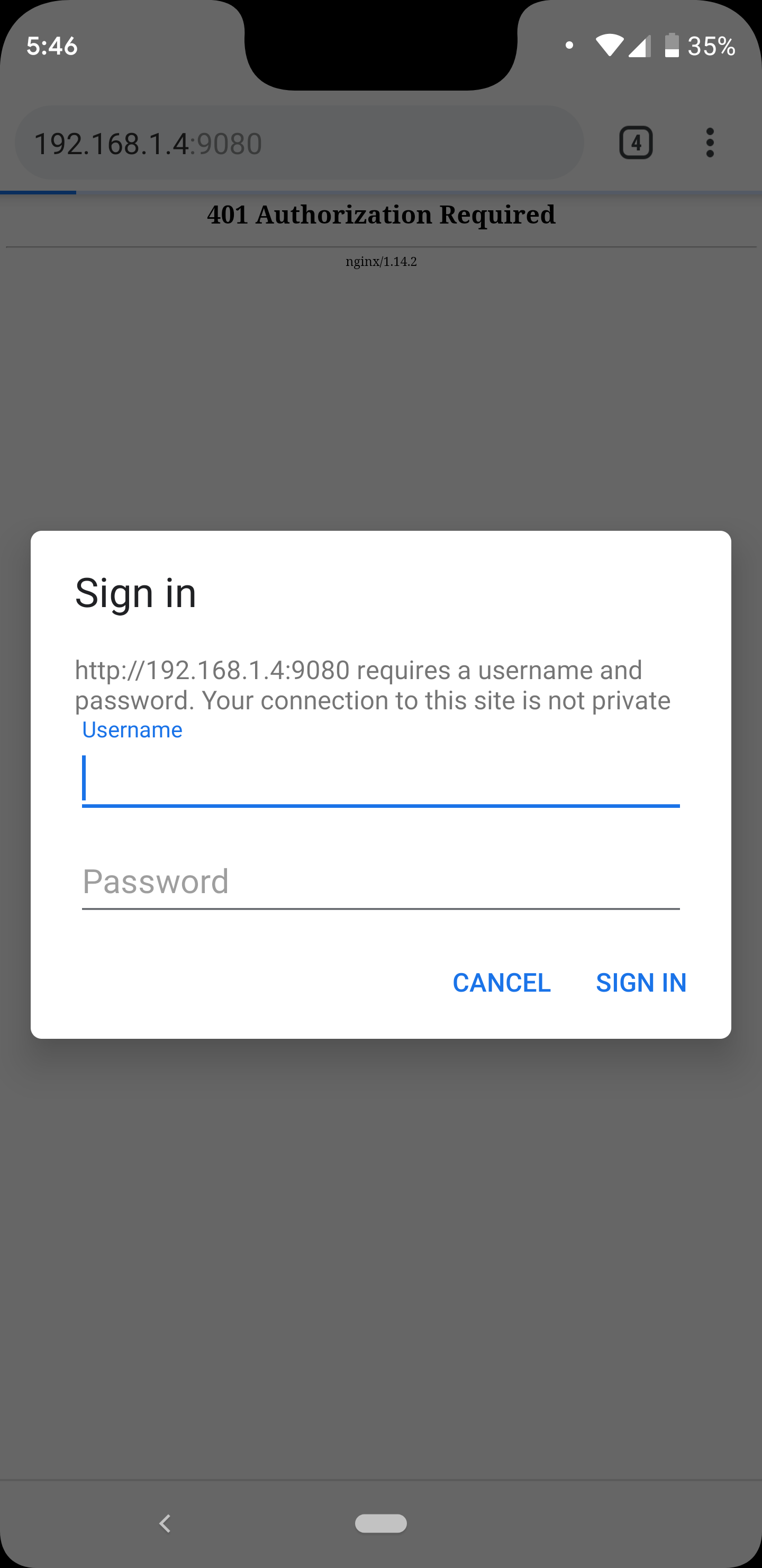

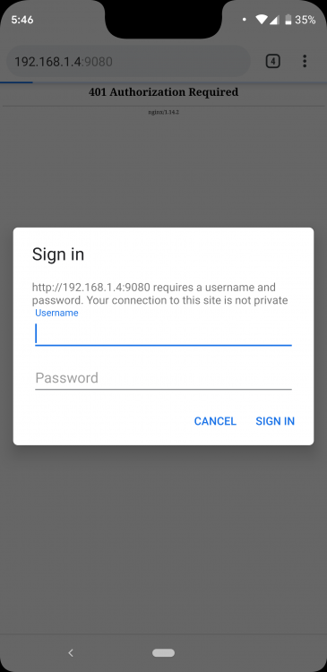

Interesting. When I go to the :9443/ in a browser I get the default browser authentication popup and I log in with the username/password I created with the script inside the container. I can definitely verify that Sonarr/Radarr/NZB360 don't require authentication to the :9443/rpc2 endpoint currently.
Maybe I should delete my container/appdata and start from scratch?

For reference...
(And in NZB360, the upload/download speed update every 5 seconds so it's definitely making a full connection)
ok i was getting tripped up by my reverse proxy blocking access to /RPC2 externally, tried it internally and you are correct, i can indeed access /RPC2 with credentials. so had a look at the nginx config and this is the fix:-
