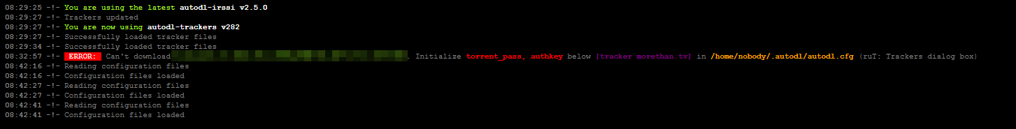

i'm using autodl-irss,
but after a restart of rutorrent or a update i'm getting always the following error.
I then need to go to the autodl-irss settings and just click on the settings and then i start to work again.
most of the time.
