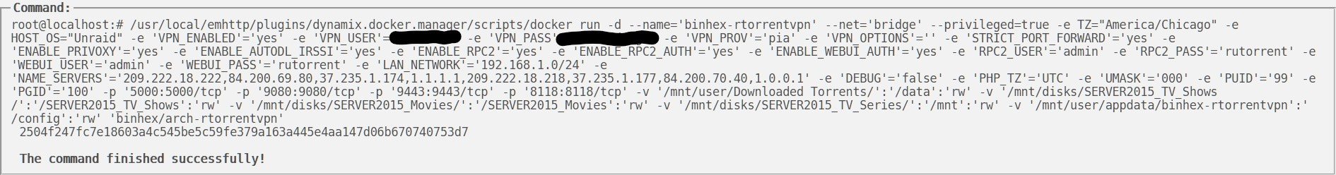

I'm new to unraid and rtorrent but I've been able to get this docker up and running for the most part as far as adding and seeding but have hit a wall with how to move  completed torrents.
I have all of my torrent files stored on another server and would like to continue doing that for backup purposes. I setup my folder shares from the other server with the unassigned devices plugin and can access everything just fine with krusader but when I use the "save to.." function in rutorrent I only seem to have the original download folder as an option.
I've tried setting a new paths to the folders in the settings but still just see the download folder. Am I missing something obvious? I've been using utorrent, deluge and qbittorrent on windows and have always been able to move torrents to a mapped drive but after hours of playing around and searches I am officially stumped.
Post your docker run command as explained at the first link in the Docker FAQ pinned near the top of the Docker Engine subforum.
Sorry about that. Here's the command.
You should set your Unassigned Devices to rw/slave mode.
