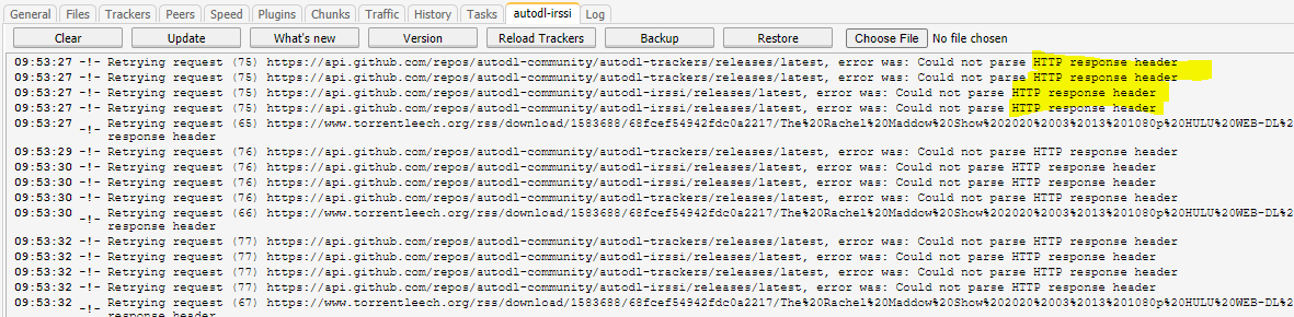

Hi just wondering if anyone had a solution to this.
I keep seeing the below to the autodl. Never had this before. Thanks in advance :)
I am also getting this error. I have disabled my autodl for now. I think the git repo might have changed their URL?, not too sure but I think this is an issue with autodl in general not just you or your setup but I am talking out of pure speculation.
I'm getting this error and actually getting similar errors when autodl tries to snatch torrents as well.  Anyone else having that issue?
Both my friend and I are getting this same error as well. I understand the issue is with autodl itself but is there any eta on when a fix is coming, whether a downgrade of the autodl version within the docker or some fix? It looks like that has been happening since March 11th cause both my friend and I haven't had any autoadded since then.
For the record, I don't think the issue lies with autodl-irssi or binhex's code.  I think it is a messed up release on docker hub.  If I build the image myself from source via binhex's git everything works great.
Looks like it. I'm building a custom image from source and can't reproduce the issue either.
its very possible that there was an issue with autodl-irssi at the time of the build (pulls from master branch), and this issue has now been resolved, so subsequent builds are ok, i will create a new image shortly and see if this fixes the issue.
Just updated it. That fixed it. Thank you very much :)
