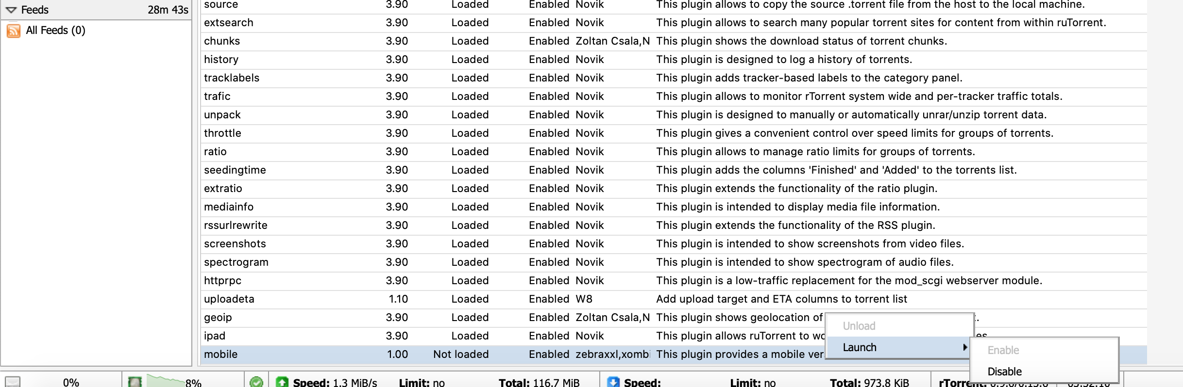

I put the extracted "mobile" folder in /config/rutorrent/user-plugins/ and then restarted rtorrentvpn i.e there is now a directory /config/rutorrent/user-plugins/mobile/. The webui loads up and there isn't a "mobile" plugin under the plugins tab as shown in pic.
Edited by ritty
thats not showing the plugins tab, also please dont display anything you are downloading, can you delete the previous screenshot, i only need to see the plugins listed - bottom half of the screen, 'plugins' tab.
Edited by binhex
As shown, it is "Not loaded" and when i disable and re-enable, it just shows not loaded
2129236645_ScreenShot2020-04-27at3_32_11AM.thumb.png.a0254422dde753c7a4c5637a40bc11f9.png
this looks to be normal, note the documentation:-
If you set plugin.enableAutodetect to true, the plugin will automaticaly load when detecting a mobile device. To force load the plugin in a desktop browser add '?mobile=1' to the end of the rutorrent url.
so try now connecting to the rutorrent web ui from your mobile device or with your desktop pc with ?mobile=1 to the end of the url to force it to load
Edited by binhex

Tried both mobile and desktop with the ?mobile=1 and neither work...dang... well i appreciate the help binhex but it is all good.. i guess it just isnt compatible.
Thanks for the help.
just tried it on my mobile, works no probs and also works on desktop, but obviously looks pretty odd.
for mobile you do NOT need to append ?mobile=1, that is only if you want to test it on desktop, just hit the rutorrent web ui normal url on your mobile.

In your plugins tab on the web ui, does it say "mobile" is "loaded" or "not loaded"?
it says not loaded, because this is a web ui i think it loads on demand, so only when a mobile device is connected.
Okay thanks Binhex. I will keep trying I guess and try to figure out what else is going on. Appreciate the help!
