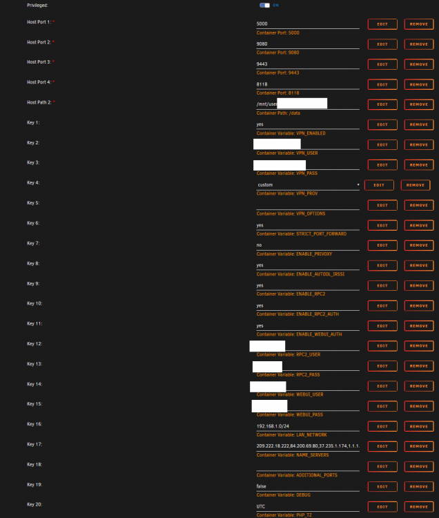

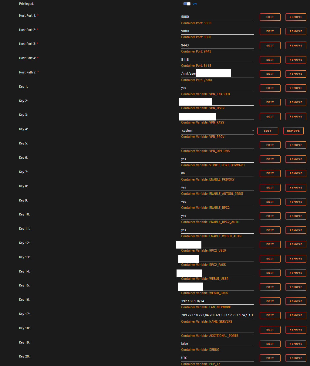

Why am I not seen as connectable? I've port forwarded the relevant port in my VPN provider. They have confirmed that it is open.
I set ruTorrent to ex. port: 30514-30514 (only this port as it is the one I opened, and btw this obviously is only an example port here)
But for some reason I am not shown as connectable. Do I need to edit something in the container config?
My container config looks like this:
Edited by plantsandbinary
if you are going by the indicator at the bottom of rutorrent then ignore it for now, the plugin for the incoming port checker is broken, there is a fix done but i need to pull down from master branch to get the fix.
No I meant other clients could not see me as connectable. I fixed it, it was a problem with my .ovpn config file But yeah that plugin has been broken for years.
