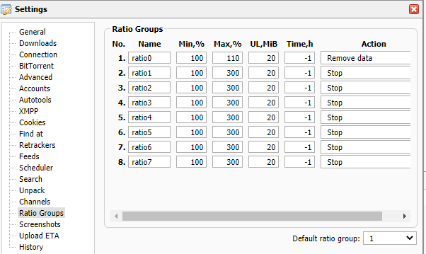

Hey - decided to give this container another go as I got sick of my slow speeds on your DelugeVPN option. It's either PIA related, or something I'm doing as everyone else isn't having slow speeds... I seem to have this sorted now on rTorrentVPN, & have a quick question. The below image is my ratio group settings... I'm looking for torrents to stop & have the data removed when the ratio hits 1.0-1.1, would this suggest it's accurate? I've stuck in a test download and the "UL target" is usually double the torrent size, no matter what the ratios are set to.
Strike that - done another couple of tests, and they seem to all be deleting themselves within the 1.0-1.1 ratio, no matter what shows in the 'UL Target' or 'UL Remaining'. Another wee thing, though, I just want to double check, but would amending the '#throttle.global_up.max_rate.set_kb = 0' to something like '350' here:
