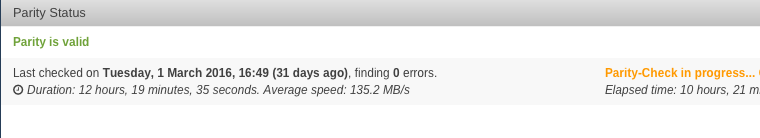

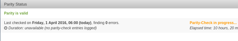

I just came home after a parity check to find 436 sync errors and part of my web gui broken
The main dashboard page will not load
The plugins page is missing a plugin
The dockers page is throwing these errors
Warning: file_put_contents(/boot/config/docker.cfg): failed to open stream: No such file or directory in /usr/local/emhttp/plugins/dynamix.docker.manager/include/DockerClient.php on line 48
Fatal error: Uncaught exception 'UnexpectedValueException' with message 'RecursiveDirectoryIterator::__construct(/boot/config/plugins/dockerMan/templates-user): failed to open dir: No such file or directory' in /usr/local/emhttp/plugins/dynamix.docker.manager/include/DockerClient.php:78
Stack trace:
#0 /usr/local/emhttp/plugins/dynamix.docker.manager/include/DockerClient.php(78): RecursiveDirectoryIterator->__construct('/boot/config/pl...', 4096)
#1 /usr/local/emhttp/plugins/dynamix.docker.manager/include/DockerClient.php(107): DockerTemplates->listDir('/boot/config/pl...', 'xml')
#2 /usr/local/emhttp/plugins/dynamix.docker.manager/include/DockerClient.php(207): DockerTemplates->getTemplates('all')
#3 /usr/local/emhttp/plugins/dynamix.docker.manager/include/DockerClient.php(324): DockerTemplates->getTemplateValue('emby/embyserver...', 'Registry')
#4 /usr/local/emhttp/plugins/dynamix/include/DefaultPageLayout.php(292) : eval()'d code(69): DockerTemplates->getAllInfo()
#5 /usr/local/emhttp/plugins/dynamix/include/DefaultPag in /usr/local/emhttp/plugins/dynamix.docker.manager/include/DockerClient.php on line 78
The VM tab is showing this error
Warning: file_put_contents(/boot/config/domain.cfg): failed to open stream: No such file or directory in /usr/local/emhttp/plugins/dynamix.vm.manager/classes/libvirt_helpers.php on line 375
My syslog is spewed full of errors. The flash share is empty if i access it, and every share is publicly visible and accessible on my network even if they are set to hidden
Bit of a worry considering i have private data on these drives. I've got to do a reboot as this is too much of a risk to leave as is
