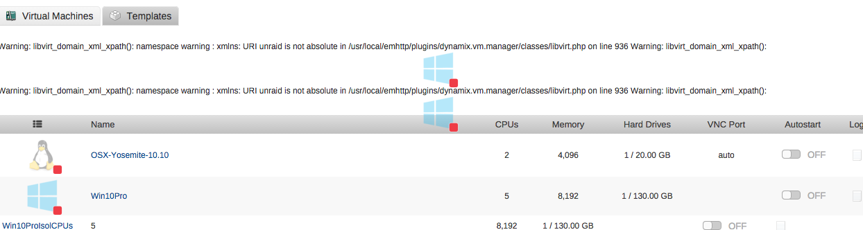

Docker updates worked perfectly but now I am having some issues getting my Win10 VM updated.
I went into the VM tab and attempted to "edit" the VM (Win10ProIsolCPUs) so that it would update to the new settings. I may have done something wrong during that process because now the VM wont start and their are errors displayed on the VM tab. See screen capture.
I have copies of my old XML file and copies of the Win10 disk image. Should I attempt to fix this current "edit" or would it be better to use a template and import the existing Win10 disk image and then make changes to the generated XML if needed?
edit
I went into terminal and Virsh to see if I could start the VM from there. It reported that the VM started and when I turned on my TV the VM was being passed through Audio and Video as well as USB controller and attached devices. See screen shots.
The VM tab is still showing errors and the dashboard is no longer showing my working Dockers or VM's
Diagnostics attached
Couldn't add the diagnostics file to the previous post so here it is
Jude,
Please try booting into safe mode and report back if the errors persist.
Restarted in Safe mode same errors showing on VM tab page (see screen cap)
Clicking on the Windows icon brings up the menu but it will not start the VM.
Using the Virsh utility I was not able to start the VM

error: internal error: process exited while connecting to monitor: 2016-03-29T16:49:35.257351Z qemu-system-x86_64: -device vfio-pci,host=08:00.0,id=hostdev3,bus=pci.2,addr=0x7: vfio: error, group 13 is not viable, please ensure all devices within the iommu_group are bound to their vfio bus driver.
2016-03-29T16:49:35.257415Z qemu-system-x86_64: -device vfio-pci,host=08:00.0,id=hostdev3,bus=pci.2,addr=0x7: vfio: failed to get group 13
2016-03-29T16:49:35.257439Z qemu-system-x86_64: -device vfio-pci,host=08:00.0,id=hostdev3,bus=pci.2,addr=0x7: Device initialization failed
Edit
Booted up again in normal mode. Errors still on VM tab but able to use the Windows icon menu to start the VM
Ok, you need to boot up in safe mode again, but please comment out these lines from your go file (or make a backup and revert to the stock go file):
cd /boot/packages && find . -name '*.auto_install' -type f -print | sort | xargs -n1 sh -c
sleep 30; blockdev --setra 2048 /dev/md*
unraid_notify start
# Set up daily SSD cache trim for unRaid cron
fromdos < /boot/custom/DailyTrim > /etc/cron.daily/DailyTrim
chmod +x /etc/cron.daily/DailyTrim
#### Snap outside array disk mount and share
/boot/config/plugins/snap/snap.sh -b
### Mount and share snap disk
/boot/config/plugins/snap/snap.sh -m vmdisk
/boot/config/plugins/snap/snap.sh -ms vmdisk
I probably need to add this to the OP of this thread, but if anyone has an issue with the beta that has customized their installation with plugins, scripts, or other modifications, you need to strip down to a stock setup before posting an issue.  Safe mode is ok to use if all you have are plugins, but in your case, you have heavily customized your setup and almost any of those things could be causing this breakage.  If the issue persists, the next step I will resort to is having you recreate your libvirt.img file, manually copying the XML for your VMs to safe place before you do so.
