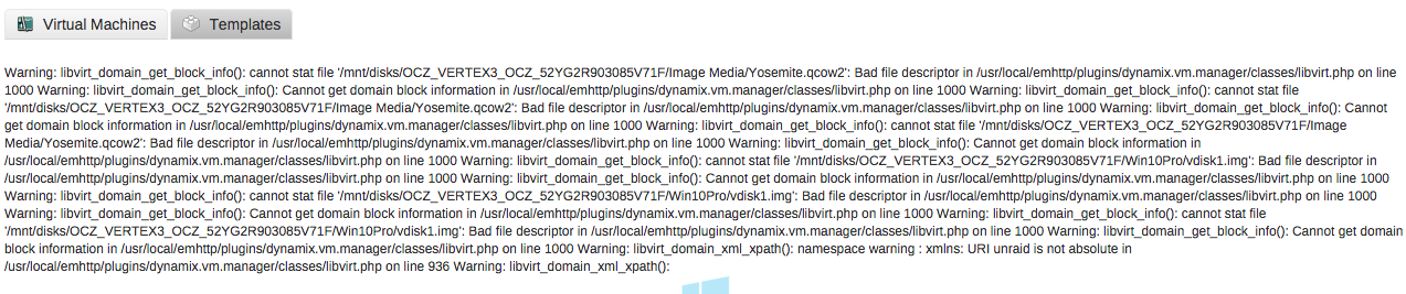

Docker updates worked perfectly but now I am having some issues getting my Win10 VM updated.
I went into the VM tab and attempted to "edit" the VM (Win10ProIsolCPUs) so that it would update to the new settings. I may have done something wrong during that process because now the VM wont start and their are errors displayed on the VM tab. See screen capture.
I have copies of my old XML file and copies of the Win10 disk image. Should I attempt to fix this current "edit" or would it be better to use a template and import the existing Win10 disk image and then make changes to the generated XML if needed?
edit
I went into terminal and Virsh to see if I could start the VM from there. It reported that the VM started and when I turned on my TV the VM was being passed through Audio and Video as well as USB controller and attached devices. See screen shots.
The VM tab is still showing errors and the dashboard is no longer showing my working Dockers or VM's
Diagnostics attached
Couldn't add the diagnostics file to the previous post so here it is
Jude,
Please try booting into safe mode and report back if the errors persist.
Restarted in Safe mode same errors showing on VM tab page (see screen cap)
Clicking on the Windows icon brings up the menu but it will not start the VM.
Using the Virsh utility I was not able to start the VM

Booted up again in normal mode. Errors still on VM tab but able to use the Windows icon menu to start the VM

OK so I made the changes to the Go file so that it is running as stock.
I rebooted into Safe mode. Their are a number of errors on the VM tab. Most of them relate to the missing SSD drive that the VM images are stored on (I am now using the Unassigned plugin to mount that drive). The error that shows whether booting in Safe mode or not is there at the end of the list see screen cap.
