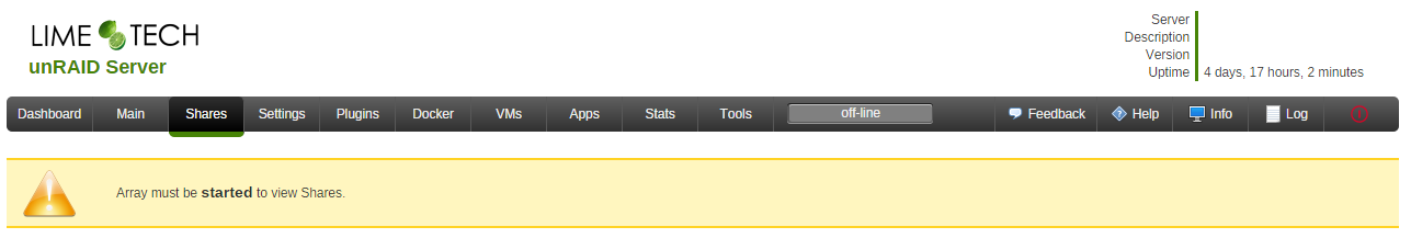

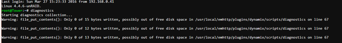

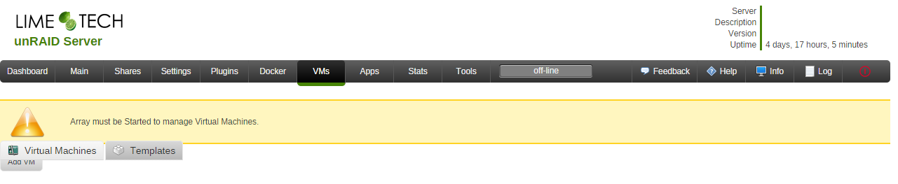

Today I experienced a GUI failure in 6.2.0-beta20 that appears to be identical to what I reported happening in 6.2.0-beta19.  Specifically my dashboard, main, shares and VM show that the array isn't started.  I am not able to download diagnostics as I get a 404 error.  Not able to get diagnostics from the command line.  Am able to get the system log from tools and the docker tab is fully accessible.  All dockers still work, the VM's are still working and I am able to access the shares from windows as well as from MC.  This has been happening on my system since using 6.2 and the strange thing seems to be that the duration between fails is at least 4 days.  As I asked in beta19, any advice appreciated.

You ran out of memory... Possibly you're allocating too much memory to the VMs or one of your docker containers is saving files into RAM -> bad mappings?
Reboot and try the diagnostics again.  Failing that,
Edit the file on your flash drive config/disk.cfg
Change the line that says startArray="yes" to be startArray="no" and reboot

Diagnostics attached.  I changed my two OPENELEC VMs from 4 to 2g.  Honestly not sure what they should be but didn't think it would be an issue in that I have 32g on my system.  How would I know if something was saving files into RAM?  No sure what to look for.  Thanks for the help.

Very likely you run out of space in /var/log, which by default can hold only 128MB. syslog, VM logs and docker logs are all stored in this space.
Look at the Dashboard page in the GUI, it will show the utilization percentage of /var/log. Alternatively log into the CLI and do
df -h /var/log
