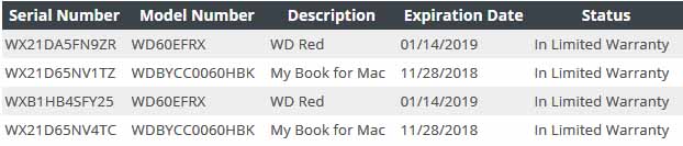

Found the problem ... did a warranty check on WD's site to see if there was an obvious difference in the dates of these drives -- and discovered something very interesting ...
The two larger drives (clearly the correct size for 6TB WD Reds) show as "WD Red" drives
The two smaller drives show as "My Book for Mac" units.    Clearly these were removed from an external enclosure.  If you didn't do this, then I'd guess you bought these from a seller who was harvesting drives from an external enclosure and selling them as OEM.    Note that both Newegg and Amazon act as agents for 3rd party resellers [both sites will show when this is the case -- if it shows "Ships from and sold by Amazon.com", or "Sold and shipped by Newegg", then it's safe, but if it's from another reseller you could encounter this kind of issue.]
Here's the actual result of the WD Warranty check for your drives ...
You shouldn't have to do that though, this is an unwelcome and uncommon surprise.  I'm thinking it might be good to put out a warning on one of the hardware boards here, to avoid the WD60EFRX-68MYMN1 model for parity drives.
Fortunately this isn't an issue => as you can see from the posts I just made the WD Reds are fine ... the drives that are a bit smaller were harvested from an external enclosure => which is already known to be an issue in many cases.    The real question here is who was selling harvested drives as new OEM drives !!    I doubt it was either Amazon or Newegg ... it was almost certainly one of their 3rd party sellers, since daggah said he bought all of them as OEM drives.
